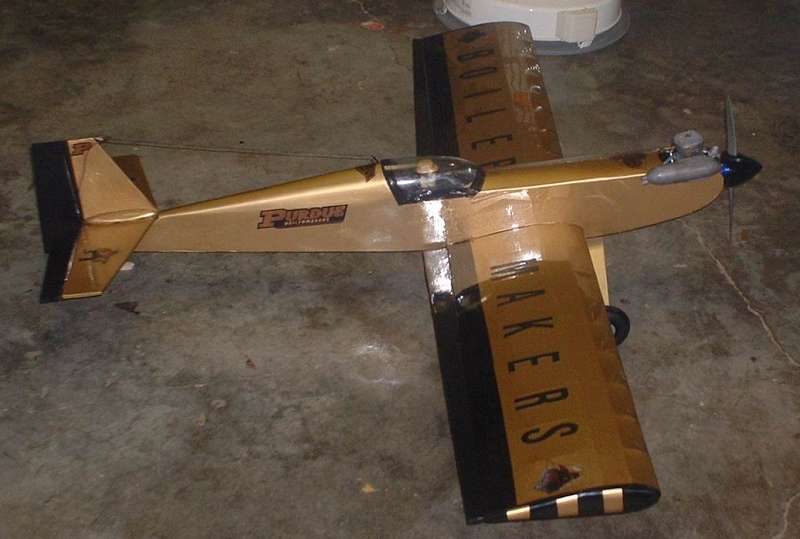

I used a push rod tube to make a mast on my 4* 40.
ID:	98746   Click image for larger version
