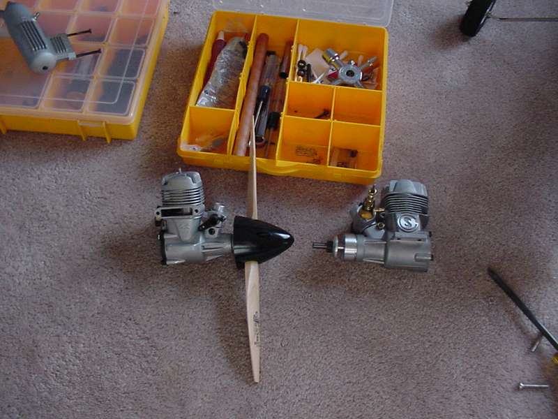

Was at base hobby shop today and wound up being forced to buy Super Tigre GS-40 ring. This engine has been in the case forever, and I got a pretty good deal on it. It's the older version with the non-silent muffler. Would have prefered GS-45 but this should haul the Avistar around with a little more uumph than the old LA. Should be no problem to mount, looks like exact match size wize, but is a little heavier. Was looking for some hints/suggestions from any of you that have up-engined your Avistars... and please, please don't tell me I should have gotten an FX-46, I hear that all the time at the field. S-T was a LOT less expensive! I'll post some pics as soon as I get home and get the camera out....

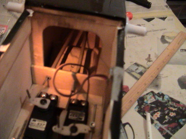

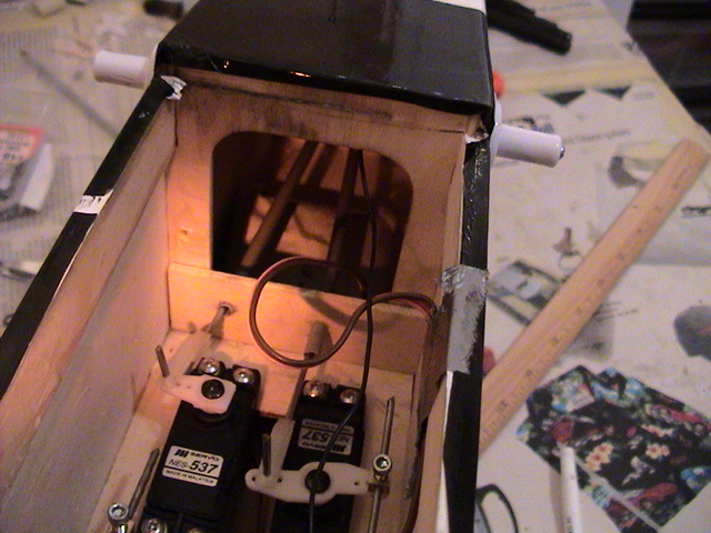

I have a MDS .48 in my avistar and it weighs a lot more. What I did was move my battery behind the servos in a closed area right under the ele. and rudder pushrods. It is still a little nose heavy but better then tail heavy.

The battery is in the far back. I used a few layers of duct tape which works ok. If you use duck tape it could slide back so tape the wires together so they do not pull apart. The best would be double sided foam tape that is fairly thick so it will stick to the pushrod tubes.

Cessna I would advise against taping anything to the tubes. You will put pressure on them and may cause some binding and trim changes. Just be sure the pack is securely mounted. Maybe a wire tie can be used to tie it down.

I mis spoke a little, I have it taped to the bottom but it is not touching the tubes. I think it would be better if you made that area a little smaller and a tighter fit so the pack is not rattiling as much by maybe having support the tubes up. But now that you tell me it can be bad you might just want to tape or glue down rubber padding to keep it from rattling and it will be more secure scence it is glued not taped.

Well, had it in for a while. Having some problems getting it to run right, would run on prime, rich, then lean out, then quit. Was thinking that maybee the needle valve is too high, it's about 1/4 inch higher than the LA's was, everything else seems OK. Fuel lines not kinked, etc. I set up needle valve as per S-T instruction book, 3 turns open, didn't play with low speed needle. Will re-mount this afternoon after flying, at field, and see if I can't drum up some more helpfull suggestions...

I tried balancing plane with S-T in the other day... seems like moving the battery behind the pushrods isn't going to be enough! It balances right on the fwd. edge of the CG range. How did you get your battery under the pushrods anyway? dosen't look like there's enough room to slide it in.... thought about a hatch.

How many cells and is your battery flat or stacked? You need to fit it in at an angle and use plyers to slide it under. The hardest part of the whole kit
