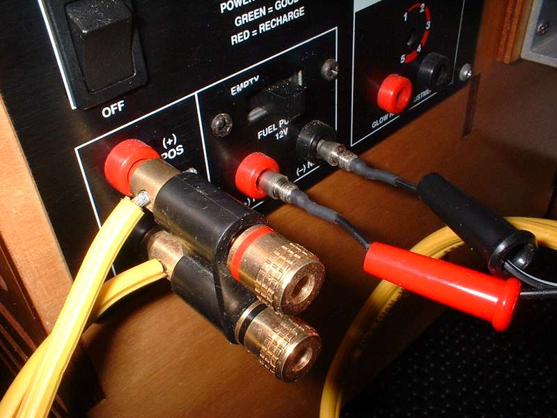

This is how I did mine. The speaker plug on the left side of the power panel is for the starter, while the banana plugs on the right side are for the pump (covers removed to show the wire joints. The heat shrink is needed to strengthen the solder joint against fatigue). The speaker twin plug has the exact pitch for the power panel socket and the heavy gauge wires from the starter just screwed on conveniently.

And a close up view of the plugs. Hope this helps

wings, there are a few version of banana plugs. For heavy gauge wires, you need to use the heavy duty type. which type did you use ?
