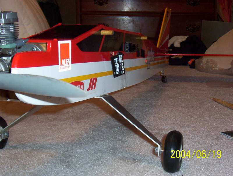

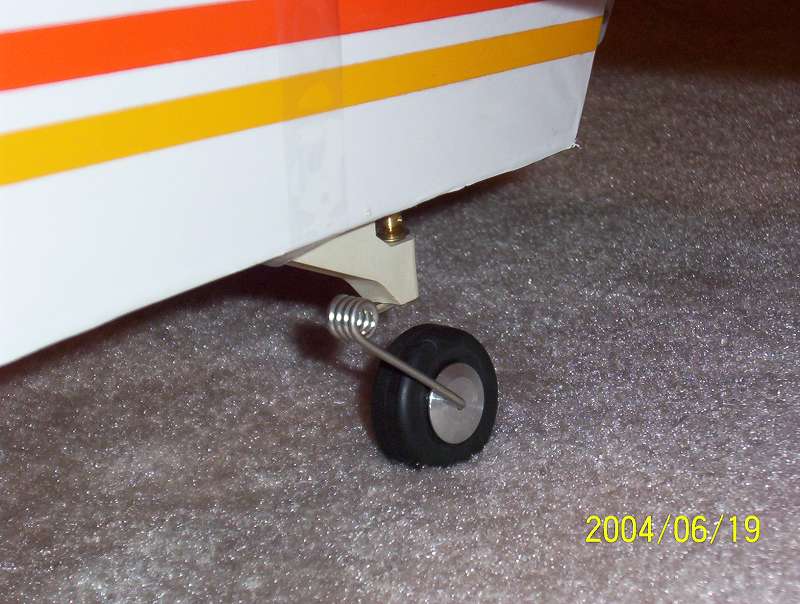

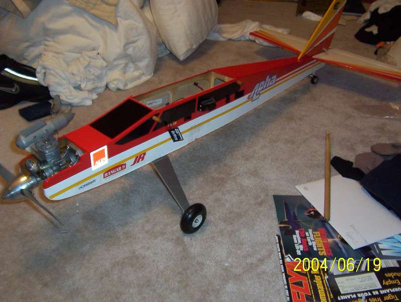

Well I went home and found out that I had the parts laying around so I decided to do my own conversion. I have some Pics of my plane with the parts in place for a dry fit. I know I have to glue my voltwatch back on the side.

i see you had to move the main gear up a bit...did you renforce the area where it will screw on?

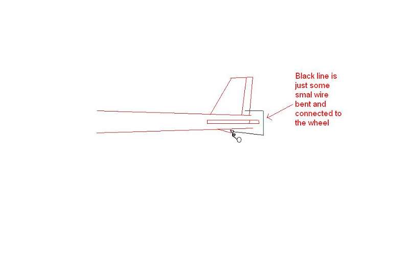

yea, I also got a new idea on steering. Here it is
EDIT: Sratch that idea

I've converted two alphas to TD. Glue some thin firewall-type plywood under the fuel tank where the gear screws to and run another push rod to a steerable tail wheel. It makes the plane a lot nicer.

I think im going to run a pushrod like you said but in those pics above, does my gear look far enought forward or not?

It looks close, but I'd mount them so the main wheels sit below the leading edge of the wing. If you mount the gear just forward of that former (or bulkhead) you'll be fine.
Adding a pushrod to the tailwheel isn't very hard. You might get away with a "castering" tail wheel (no control), because prop wash over the rudder can sometimes be enough, but I'd recommend the rod.

Your mains should be mounted so that when the plane is sitting in it's three point attitude (tail down) the mains are just in front of the leading edge of the wing. Whe the plane is sitting up on the mains, they should be under the leading edge. As long as you've got them pretty close to this position, they'll be fine.
