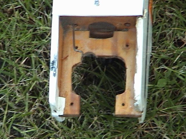

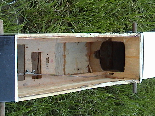

Hi All,
Bought a glow plane today, graupner trainer with servo and 61 motor all for just 15 dollars!!
Now I have gotten the damn thing home I cannot work out the best way to fit the motor. I have been to hobby lobby and looked at the different types of motor mounts but have no idea which one I need! Can anyone make any suggestions please?!?
Also, how do I couple one of the servos to the front wheel for steering as I see it has that facility built in.
I have attached some fotos (i hope) so you can see the setup at the front.
Thanks in advance

it looks from the pictures that your motor moun is built in. You should just drill the holes and mount the engine(if it does not fi the holes provided). Second you attach the front wheel to the rudder servo usually by placing the control arm in the servo horn on the opposite side from the rudder. meksure everthing pulls in corect direction.

Mount the motor on two aluminum strips about 1/8th inch by 1/2 inch by whatever length fits. Bolt the strips to the plane and the motor to the strips.
One look at a nose gear steering rig in someone's plane will tell you more than a bunch of words. But it's a flexible cable inside a plastic tube, with small connectors on the servo wheel and the nose gear steering arm.

OK, but do I need to mount any vibration absorbing material in between the motor and mount, or mount and wood??

No, not necessary, just make sure it is tightly bolted.

You don't need soft material between the airframe and engine. HOWEVER... use allen screws with locking nuts to fasten it. Buy the allen wrench set and the socket set, you'll use them. If you don't know what allen screws or locknuts are, ask your haardware man.

I hope this will give you an idea as this is my setup.The front of the plane is to the left, top left servo is for throttle,top right is for elevator,bottom right is for rudder and front wheel.Hope this helps.

That is an old style mount. Haven't seen one like that in years.
It is designed to be larger than the engine. You need to make a plywood plate (3/16" to 1/4" thick) that will bolt on to what's already there.
The idea is that (In case of an accident) the plate you make is supposed to break thereby saving the rest of the plane

I would cut the other, unusued arms off your elevator servo. It's a slim chance that it and the rudder servo will bind, but better safe thanb sorry. Otherwise setup looks good.
