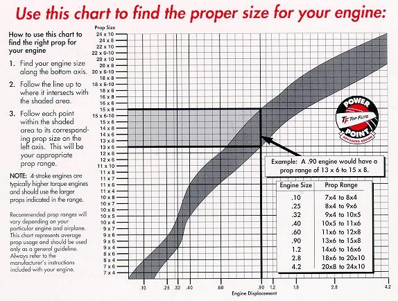

Copy, and print for your shop.

Cool graph, Jett'.
Everyone I know with a 160fx is running an 18x6 or 18x8, which oddly is out of the range shown in that chart.

Or a slow stick!
The chart is old(er), so maybe it's out of synch for the larger engines.......I just pass along what I find, and I found it on the web- recently.

ORIGINAL: MHawker
