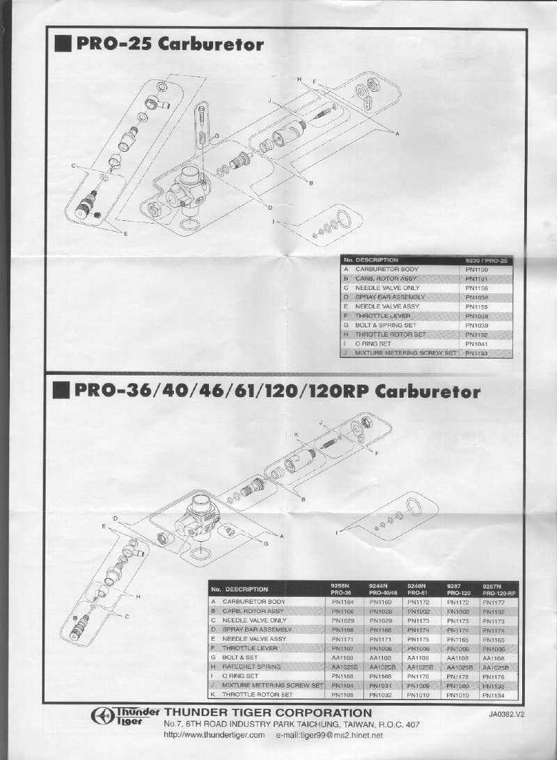

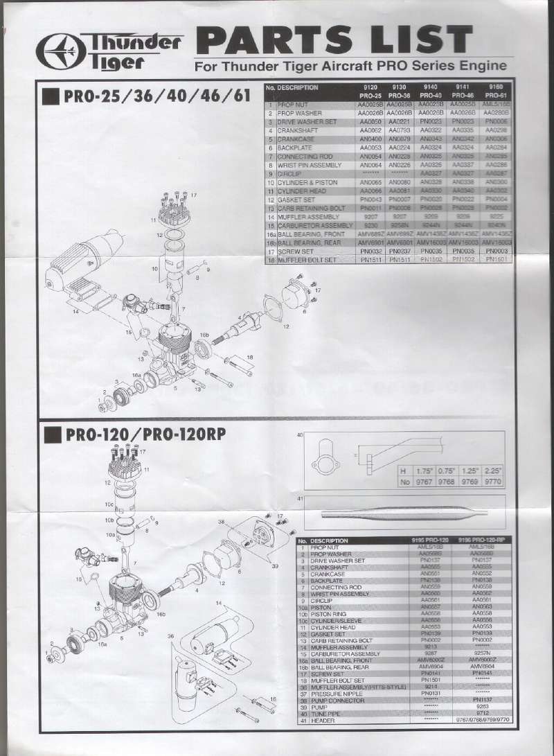

best I can help you with is a copy of my parts list. It does have an email addy at the bottom.
ID:	163093   Click image for larger version

just noticed how cruddy those are, if you need/want better scans, lemme know, will scan it properly this time...lol
