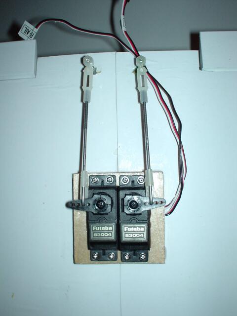

I'm getting my Avistar ARF tomorrow, and I'm considering trying to install two servos for the ailerons (one each), so I can use the flaperon mixing on my radio to get flaps as well.
Anyone else try this with the Avistar, or other similar trainer plane?
I think I can mount two, side-by-side (with servo arms point out, away from each other), without notching out anymore wing ribs, but then I may have to much of an angle on the control rods. I will have to make a new servo mount for them and cut out a larger section of the wing's bottom sheet to fit them. If I move the servos out to have the arms point inward (towards each other) and get the control rods perfectly straight again, that will require cutting out separate holes for each in the bottom wing sheet, and possibly notching out another wing rib (besides the root rib that is already notched).
Any comments, suggestions?
I thought about just building it as spec'd and screwing around with adding another servo later, but then I figured it would be much easier to build it this way from the start, and not have to break off the epoxied single servo mount later...

Ask yourself why you want flapperons... "Why do I want flapperons?".
If your answer is "for fun", "to experiment with 3D stuff", "because I can", then go ahead and install flapperons.
If your answer is " so that i can slow down for landing, get better take-offs, or maybe more stable, slow flight", then you do not want flapperons. The Avistar has fantastic slow speed flight. It floats, and if you use flaps then you probably will struggle to get the plane on the ground.
For typical usage (as intended by the designers), the Avistar is *really* good. It has one aileron servo because that is all it needs (you are not going to be doing 3D with the avistar....)
Frankly, the plane is not going to be any better (for it's inteded purpose) with the additional servo on the aileron. It is overkill.

The main reason I want flaperons is for more lift for slower flight and landing/takeoffs. The Avistar has a semi-symetrical airfoil, and I've read it has about a 35mph touchdown speed...

35MPH?! That doesn't seem right! My tiger 60 touches down WAY slower than that.. And it has a fully semetrical wing. Anyways I think flaperons would be fun on trainer types. You could have a sort of bush plane.. Flaps bigger tires and a bigger engine and voi la perfect bush plane. If you still want to do the flaperons then go to your LHS the owner is bound to have planty I dea's for servo trays or look at other planes servo trays for Idea's.
Nothing wrong with trying the flaperons, but I too wonder about the effectiveness on a trainer, even an Avistar. It may land a bit faster than flat bottom wing trainers, but I doubt that it's substantially faster.
Remember too, that flaperons will likely cause a change in pitch when applied, which will mean having to "get on the elevator" when deploying them, or trying to mix some elevator with the flaps. What I'm saying here is that most beginners have their hands full just trying to learn the basics, without having to deal with bells and whistles.
However, adding the flaperon capability now does not mean you have to use them now. You could leave the function disabled until you've learned the basics, then kick it in later on.
Whatever you decide, have fun!
Oh, and I'd place the servos side by side. As ,ong as the angle isn't really severe, it shouldn't be an issue.

Flaperons are a bad idea on most RC airplanes.
When you deploy flaperons, you are increasing the angle of attack on the outboard portion of the wing relative to the inboard portion. This means that the outer part of the wing will stall before the inner part of the wing.. The dreaded "tip stall." The plane will be less stable at slow speeds than without the flaperons deployed, and you're much more likely to spin it in if you get too slow. This is the exact opposite of what you want!
Look at full scale airplanes, you'll see that flaps are always inboard. Spoilers (if exist) are outboard. This is by design to improve handling and stall characteristics in slow flight.
If you want to get a plane to slow down for landing and be more stable, the right thing to do is mix spoilerons, which reflex each aileron slightly *up.* This will force you to fly at a higher angle of attack (read increased drag), and will help the inner portion of the wing to stall before the outside (where the ailerons are). This will help the nose to drop, while still maintaining some aileron control in a mild stall. Your plane will last longer.
I know this is backwards from what it sounds like it should be, but there are some really good reasons for not using flaperons on most models. Spoilerons can come in handy, especially in wind, I have them programmed on several models.
IMHO, dual aileron servos on an Avistar is not really necessary either, when you're ready to benefit from independent servos, you'll have outgrown your Avistar anyway!

Well, I got my ARF, and had a look at the wing and aileron servo mount, and it looks like a no-brainer to put in two servos. Just have to cut out a little more of the bottom wing sheet and make up a new servo mount to fit two servos side-by-side. The existing mount is just a piece of 1/8" plywood (with the center cut out to fit oneservo) and a couple of balsa blocks that glue it to the wing.

Just a follow-up...
I finally got my ARF together, and have flaperons setup on my Avistar (see the pictures below). It was pretty easy to make up a dual servo tray for the wing. I flew it for the first time today, with the help of two very experienced club members! I was able to take off a few times on the second tank, and I landed by myself on the third tank! Nice calm day... very nice for a newb to fly!
I haven't messed with the flaps while flying yet, so can't say how they work... will post another update after I've soloed and had a chance to try them out (I'll let you know if it was worth the extra effort
