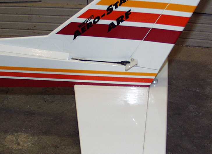

so we just get this new avistar 2... takes us about a week to put togethor (me and my dad are big time newbs) we finnally get it togehtor i take it out front... run one tank through it fine... now i go to taxi it in our street.....
after messing with the idle a little bit i finnaly get it to go. and within 2 min it dies... (thsi is not the problem) i go to wheel it in and i pick it up by its fin (with the front wheel on the ground) i saw others do this at my local track and what happens??? the fin snaps off [&o] i was so shocked i think i just sat there in the street for like 5 mins... the worst part is my dad wasnt out there and i was so afraid of telling him i just wanted to kick the plane and throw it off my roof. after picking it up and wheeling it in i had to tell him...
is there anyway of fixing this??? can i just glue CA glue the fin back on without a problem... im so mad righ tnow its not even funny.

I think you're lucky it happened how it did. Much better for it to have happened on the ground, then while you had it up in the air! [X(]

Yes you can use medium Ca to stick back together.
Only tail tow with tail-draggers. It's like balancing and rolling a wheelbarrow with one center handle. So much strain on the thin balsa.

Do NOT use CA. It's not strong enough. Use 30 minute epoxy.

The CA on CLEAN wood is fine, will be stronger than ajoining balsa wood.
However, the epoxy will give you more working time to make sure all is
squared up well. Its a good thing it came off while on the ground, and not
while flying. Sounds like you had a week joint to begin with. (assuming that
it came off clean, not splintering the wood)

I would recommend that rather than just glue the fin back in place and leave it at that, that you should consider adding some balsa triangle-stock to strengthen the area.
For a review of a trainer that I did here on RCU a while ago (dunno if it is still accessible), the model arrived with a broken fin. As part of the review I posted a series of photos and instructions on how to make a simple but strong and lasting repair.
Since I'm not sure if the review is still around, here's the pic's to begin with, and I also enclose the text that accompanied the pics in the review:
Beginners frequently bump the fin during transport, or turn the model upside down the first time they taxi in a strong cross-wind, etc., and need to make this kind of repair - so we may as well take advantage of the opportunity to show you how easy this kind of damage is to fix.
First, simply realign the fin, making sure that it is both straight and vertical, then use thin CA to glue it back in place. Next, we take a piece of 3/8" 'triangular stock' balsa, and cut a piece of the appropriate length. Sand its ends for an aethetically pleasing shape, then cover it with a section of the excess iron-on trim strip that Falcon Trading provided for the wing center section. (They conveniently provide quite a bit more than you need for just the wing!). Strip a small section of the covering away on the fuselage and fin as shown below (right), so that we will have some exposed wood to glue to.
Note the pushrod clearance for the tri-strip on the left.
Finish by using some 5 minute epoxy to glue the tri-strip to the fuselage as shown in the photos above. Note that the tri-strip on one side must be shorter in order to clear the pushrod.

If the fin snapped off. you do not want to just butt-glue the fin back together. You may want to use some 1/8" dowels to reinforce the joint. You want to drill a couple or three holes in both the fin and the fuselage for the dowel. cut them about 1-1/4" to 1-1/2" long and glue them in. A plain butt-joint won't have the strength you need. White glue or carpenter's glue is about as good as any for this purpose. Of course slow-cure CA or epoxy would also work.
