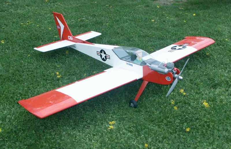

I put together a Tiger 60 arf, with a Super Tigre 75. The cg is said to be 3 3/4 to 4 3/4 from the LE. It balances at about 4 1/2 by using 7 oz. of lead in the nose. Is that unusual, or did I possibly read the manual incorrectly?

Not Unusual, a lot of people put 4-strokes in it, and it balances very nicely. 2-strokes need some weight added

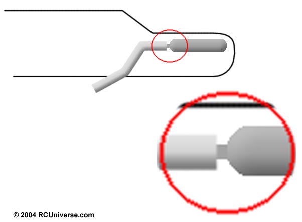

Would someone be able to reccommend some kind of pipe system to get the exhaust under the plane? I can spend nearly an hour wiping down the wing and fuselage after just 1 flight. I was thinking about using some soft aluminum tubing to bend to shape. I was having to remove the canopy to clean the inside because of the oil residue.

I just finished the Tiger 60 I built from a kit. It has a Saito FA-100 and I needed(?) to add 1/2 ounce of weight underneath the engine to balance (slightly nose heavy) at 4" back from the leading edge of the wing. I did convert to a tail dragger and mounted the engine as far forward as possible. My total weight came out at around 8 pounds, as measured on a bathroom scale. I sure hope this thing flies....

There are exhaust deflectors on the market, but they can cause a loss of power (Been there - Done that) however, recently I've been wondering if cutting a channel in one (Red area) wouldn't reduce the back pressure while still diverting most of the exhaust. Might be worth a shot.

Just finished prepping mine for tomorrow. Total (dry) weight is 8lb, 4oz. This is as weighed on a postage scale, so it's pretty accurate. CG is 4.75 in back from the leading edge. Sounds like at your weight you should have no problem flying yours, although you will probably want to move the C.G. back as you get comfortable flying this plane.
I was mistaken about the battery. I do have two rails holding up my fuel tank to the correct level, and there is suffecient room for a battery underneath it, but I must have been thinking about another plane with the rectangular hole in the center of the fuel tank tray. The battery on this plane is directly under the receiver, mounted as far forward in the wing saddle as it can. No additional weights, fore or aft added.
I chickened out and only rotated the exhaust a little bit up from where I had it. If I see any change in the "rate of mess", I might try moving it some more. I keep telling myself, baby steps, take baby steps!

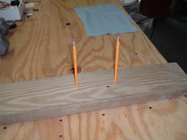

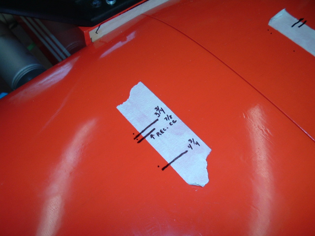

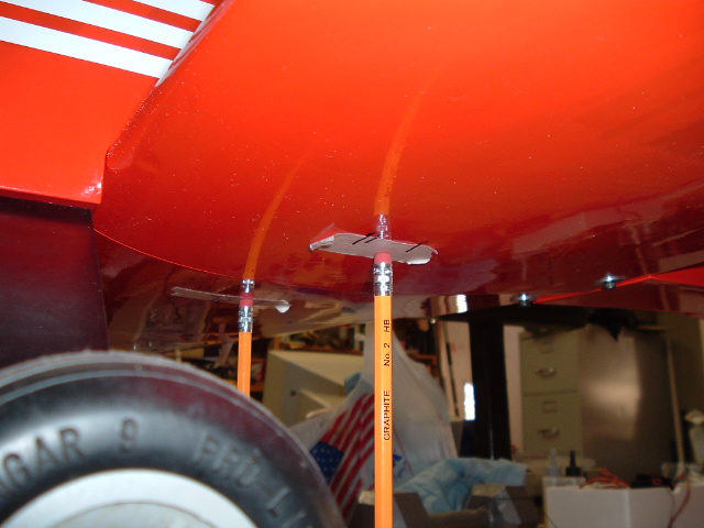

As far as the CG goes, it is right now at 4.5". Not quite the rear maximum, 4 3/4. It is simplistic, but that is my CG machine.

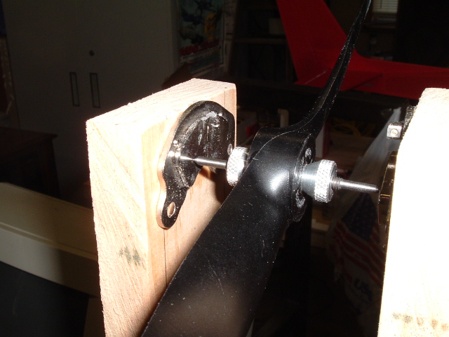

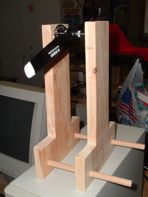

Homebuilt prop balancer. The device to hold the prop is a finger balancer, suspended between 2 magnets from discarded computer hard drives. They are fairly powerful magnets, and have held all of my props. I made the one side somewhat loose to accomodate the insertion and removal of the balancer with the prop on it.

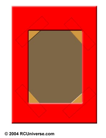

Since it's light ply, you could just use a razor blade or hobby knife. then add blocks in each corner to screw into.

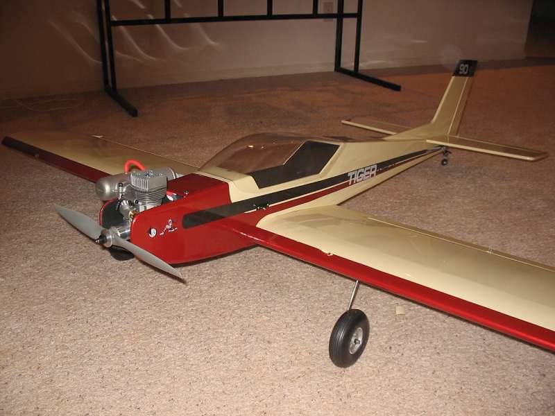

My "tiger 90" seems happy with balance, have not wieghed it. Not quite finished yet... Im a slow builder I guess. G90 in nose. Im very pleased with the kit version.

BIngo, If you want to , you can use a home-made exhauxt diverter. Thin walled tubing will work, but it should be larger than the exhaust pipe. Here's a diagram of one that I made for my son's first trainer. It was thin walled aluminum, and strapped to the side of the plane. It didn't add much weight, and it worked very well. I think the secret was using the large diameter tubing (I don't remember exactly, but it was about 5/8 tubing), it was about twice as large as the "Tail Pipe" and it allowed outside air to go through it (No tight seal).
