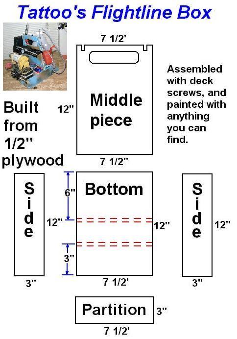

Here is one that I sniped from this site a while ago, looks simple enough, and it could be easily modified to support most any needs.
