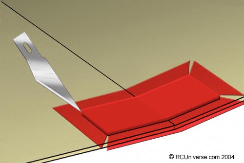

ok I am finally to covering my 4* 40 and I have the wing tips done but now I am to the torque rod blocks and it is getting agrivating I can't seem to figure out how to go about covering these and the wing hold down plates, can anyone help

I am talking about on the Trailing edge where the aileron wire and blocks are, I dont want it to look crapy but it seems hard to get between the wires thanks

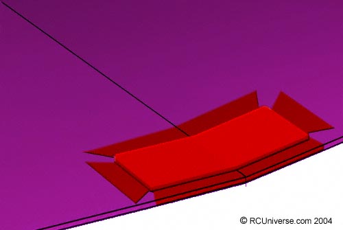

This gets a little tricky, but it's not hard. You want to do it in pieces. Here are some pics that will save me a lot of typing.
ID:	185373   Click image for larger version
ID:	185374   Click image for larger version

And for the bolt plate:
ID:	185376   Click image for larger version
ID:	185377   Click image for larger version
ID:	185378   Click image for larger version
