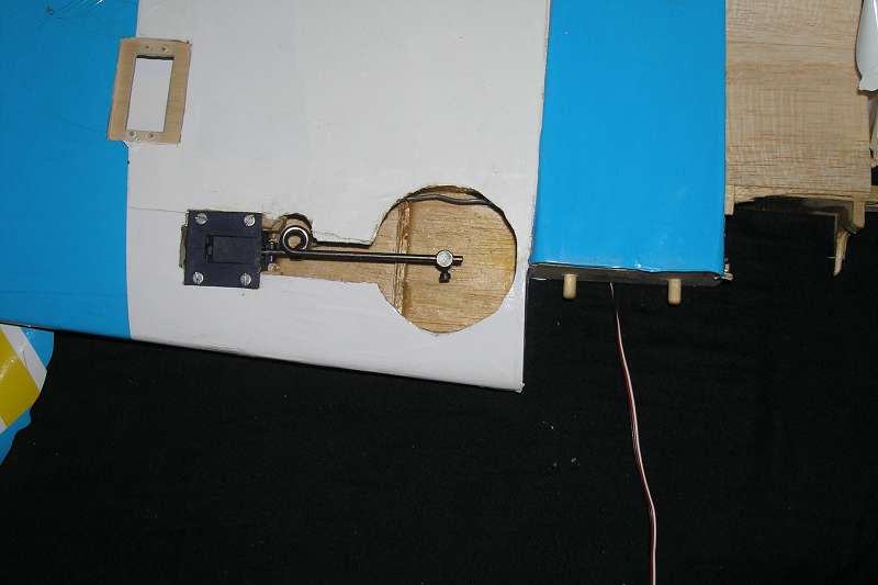

Depending on what engine your going to use you may want to make your gear longer, When I built my US 40+ Here is what is left of my wing Poor plane had a tragic death, But it will give you a good idea on where to cut the bays for longer gear.
Dauntae
