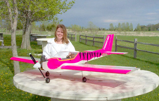

I wouldnt add any more material in tail except a small piece of lite plywood for the tail wheel bracket to attach to. My friend had a tail dragger and it worked well. I will attach a pic of it for you to see it will be ok. Remember lite is better!

I really appreciate this input. Very nice looking picture. One question. will the original location of the main landing gear still allow the airplane to rest on the tail wheel if built in the taildragger configuration, or was the main gear bent or re-located for the tail dragger configuration to work.

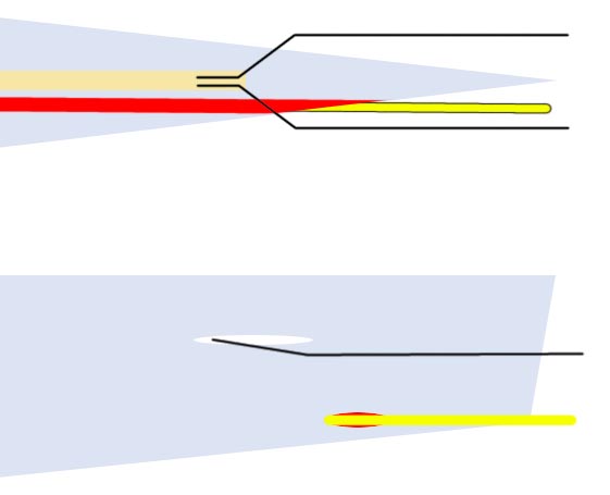

Originally posted by dickj
The only problem I know of is that the tail is heavy as built per the instructions.
I had no problems with the plane being tail heavy, I built it as designed with a nose wheel, and powered it with an OS 90FS.
It might be possible to cut some circle holes out of the heavy horizontal stab and still be strong enough. Its your choice.
When I built mine (last winter) the Horizontal stab was built-up, and not heavy at all.
A few things I would like to mention are, first, taper the rudder and elevators. It makes a much nicer look. And if your kit was like mine, the small sections of trailing edge stock that are used on the wing (everywhere except where the ailerons are) were too thin to mate up with the wing, So I just added some 1/16th sheeting to thicken them up a bit.
Also, I eliminated the torque rod between the elevators, and used a seperate pushrod for each side.

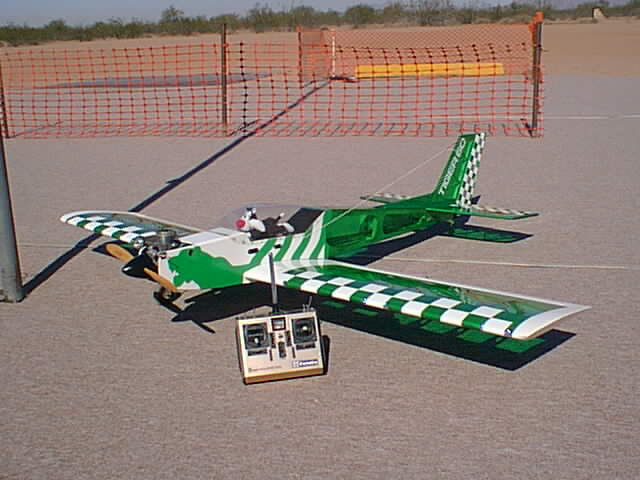

I've never had a prob with the gear blocks, maybe that's something else they fixed. It's not too late to do the twin elevator thing, just cut the torque rod that you installed and put two threaded rods onto the elevator pushrod, then run a Nyrod for the rudder. That's how I did it.
As far as engines go, a 4-stroke 91 is SWEET!
