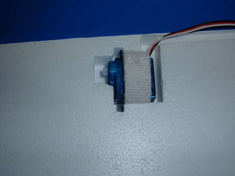

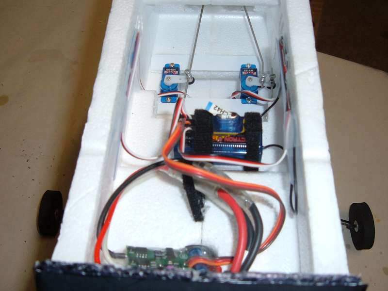

Hi VF, got up at 5am this morning to work on the plane. Wife and baby are sleeping so it's the only time I can get uninterupted ( I know you know what I'm saying). Anyhow, got a bad sinus cold and did not get to work on the plane this week so I am not ready to fly it this weekend but got a couple pics for ya. First I figured it would be hard to get at and work on the servo's so I opened the area a bit and because I am one not to ever want to permantley mount things ( so the can be repaired easily) I placed 2 thin plastic strips so that I could screw the servo's down instead of gluing them. Plus it gives the servo's a nice clean edge to rest againist. I do know of the shrink wrap and glue trick but thought this would work better.The Styrene Sheet plastic is made by "Evergreen" and is 5x12" by .040 " thick and I have used it for other models as well.Also I drilled some airflow holes in the firewall to help reduce drag. Because with the holes in the front of the cowl cut out there is no where for the air to go ? So this will also help with keeping the motor,ESC and battery cooler as well. The last pic is just a fuse shot of how it looks right now. Hope to hear from you and see how your coming along. Later

Hey man good to hear from ya. I only have 1 3 yr old and can't imagine trying time to build more than 1-2 planes a year with 2 !!!! your doing awesome. I fall asleep early now too and if I get a good 4-6 hours in then I get up early to work a little on the plane, it's 6:30 am now. I am 40 now and remember the time when I could go DAY'S without sleep. The other trick for the servos is to heat shrink shrink wrap ( recievers too) around them and then glue your servo down. then just cut the shrink wrap for repairs etc.... and redo. Awesome on the new planes !!! I was just watching the A10 videos this past Friday at work on eflightline.com and have always thought that was a great model. The P51 will be bad to the bone too and if you go brushless/LiPo !!!!!!!!!!!!!!!!!. I think my next 2 builds will be my combat wing from Atlanta Hobby and a scratch built Boeing 747 airliner from one of the 4ft wingspan foam gliders at the hobby shops. Going to use the GWS ducted fans etc... heres a link you GOTTA check out to one I hope to own one day ( always have wanted one of these types of plane to fly ) http://edfmodel.com. My buddy "V" just got the Ultrafly F-16 and I hope to see the kit tonight, he said the kit was really nice and that with the new brushless MTR they're coming out with that it will go verticle UNLIMITED !!!! He also has the BAE Hawk that he is starting to build. He also just custom built a parkzone Styrker and I am going to post the pics of it and will let you know. I have a Styrker as well and I tell you that it will be hard to beat that plane out of the box!!!! takes a beating and flies like hell. I love mine and you can fly it on the windy days. And do me a favor and send me the link to LHS I would like to check out they're site. Hers a couple pics of what I did to reinforce the control horns to the control surfaces instead of using the screws that came with ( mine were not all there) so I had to come up with someting anyhow. Later man ! PS . you can also see where I used velcro to hold down the wing servo so that I could swap them out easily between both wings ( I am going to use a Y servo cable as well.

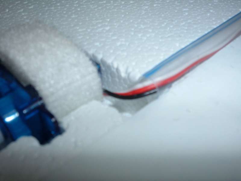

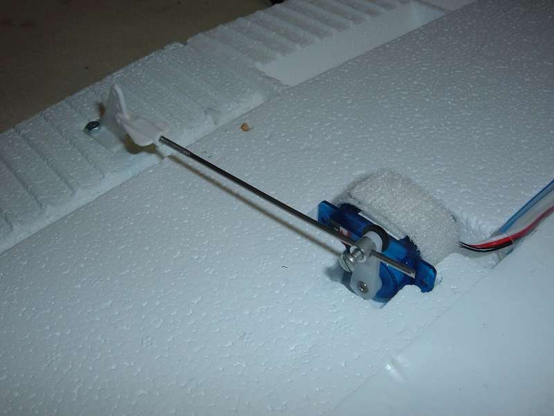

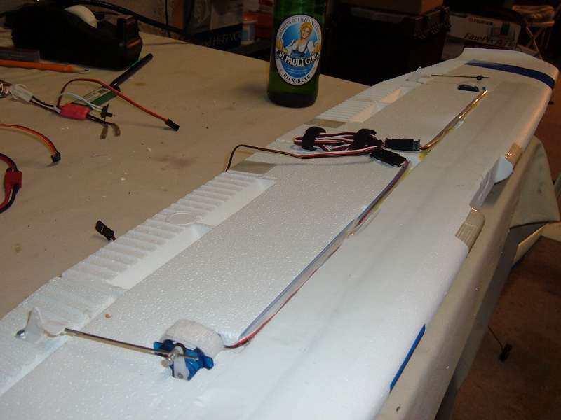

Wing wiring harness and close up of where I drilled holes thru the wing hinges and CA'ed a toothpick in to keep it from ever pulling out. After the CA dried I just snipped it flush and only did the hinges near the control horns. I did this because of the brushless as I know I will be pulling some fast G's AND THERE WILL BE SOME SERIOUS STRESS OOOPPSS

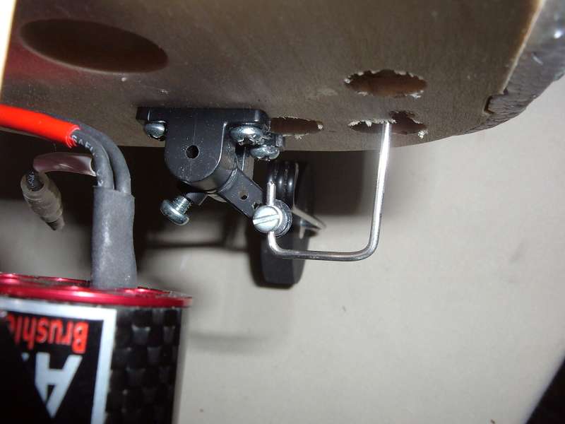

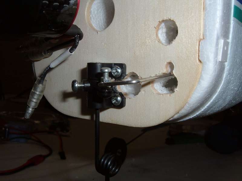

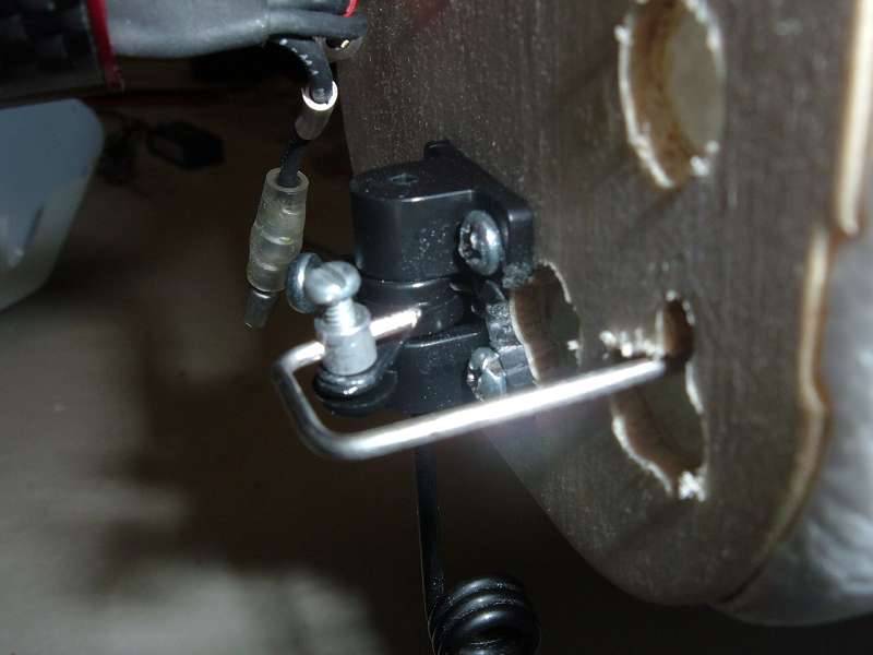

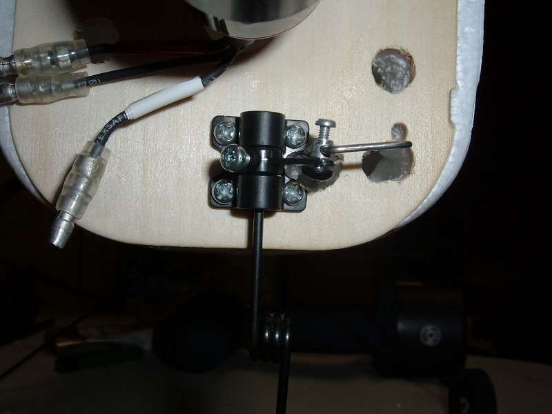

I wanted a sterable nose gear. NOTE if you install it per the intructions you will only be able to steer to the right. I did some mods so that I could steer left as well.

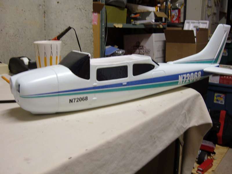

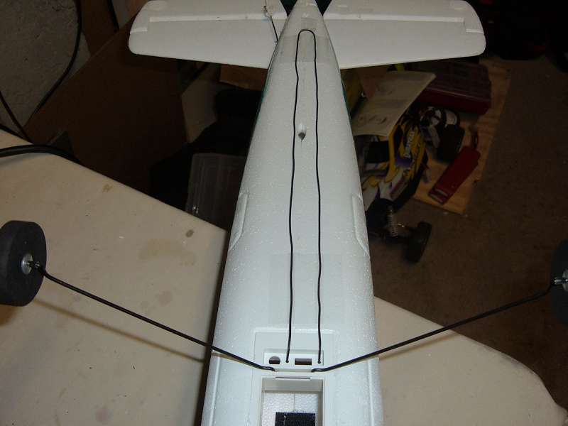

Top , bottom hatch and attena run

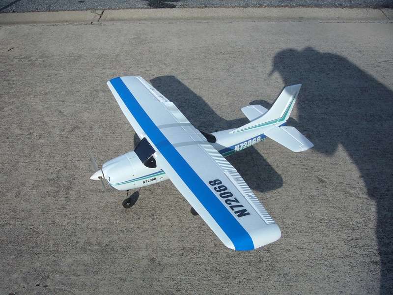

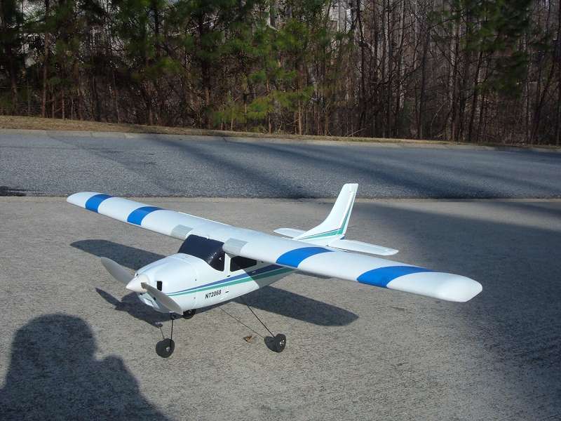

Driveway pics befor heading out !!!!!

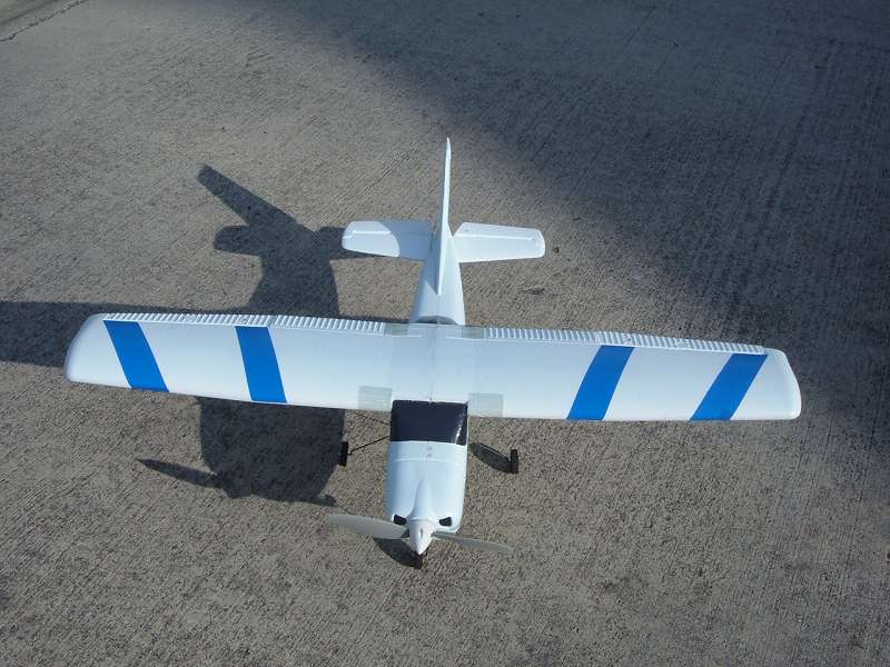

Wing with angle stipes is the slow wing. The wing with the stipe all the way accross is the fast wing
