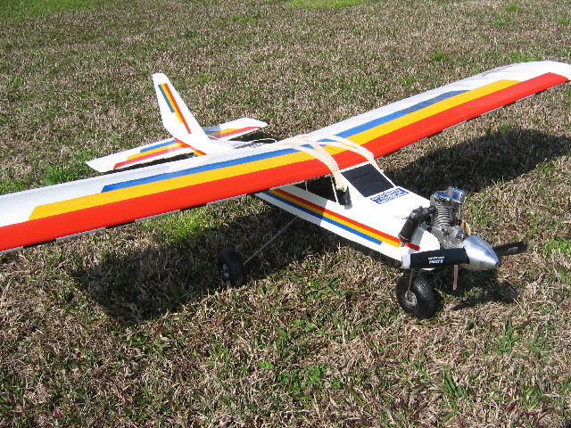

Old 03-15-2005 | 07:19 PM
DTB's Avatar
DTB
My Feedback: (15)
Joined: Feb 2003
Posts: 1,085
From: Clermont, FL
Default RE: Superstar 40 tips
Saito 72 with 13x6...
Old 04-26-2005 | 10:40 AM
DTB's Avatar
DTB
My Feedback: (15)
Joined: Feb 2003
Posts: 1,085
From: Clermont, FL
Update on the plane in the above photo. I recently converted this trainer that I have had for the past 3 years into a taildragger with a bolt on wing conversion also.
Converting to a TD removed 1 lbs of dead weight now. 4-1/2 lbs now with a Saito 72.
I'll try to post photos later.
