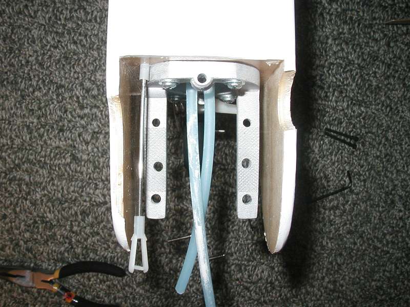

ok, i've decided to get a new engine mount because its only 10 bucks, so no plm. if all goes well getting everything charged up and flight-ready we'll (my instructor and I) be breaking in the engine and going for a maiden flight sunday morning.
i'm getting batteries for my camera today so i'll post more pictures this evening of what i did to the mount and the overall progress.

I doubt a couple of extra holes are going to affect the strength of that engine mount very much, it's metal. The plywood fire wall will break long before that mount will, even with your extra holes. In a nose in crash, it would be better for your mount and firewall to break, than your engine block, anyway...

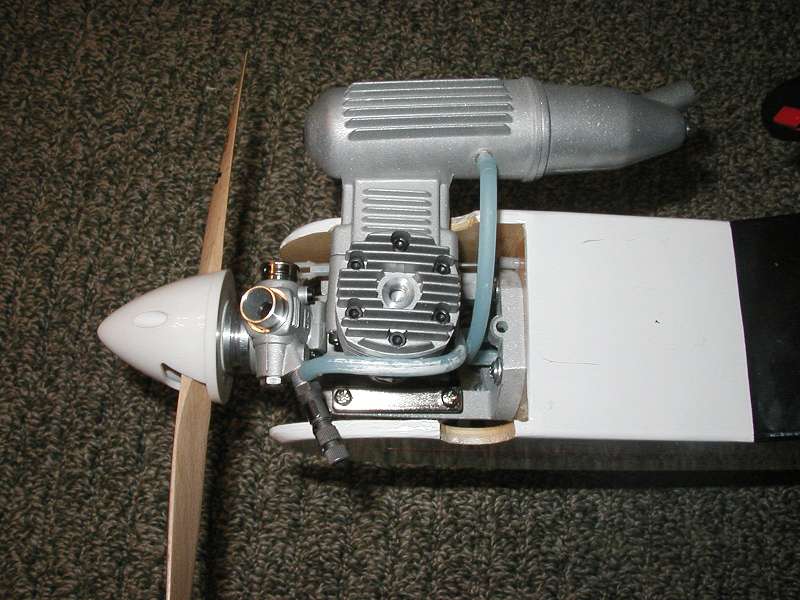

ok, here are the latest pics... the first one is of the engine mount with the two extra holes (second from bottom on either side), the second is of the engine mounted with the provided clamps, and the third shows me with the completed plane!
the only thing left is hooking up the electronics.

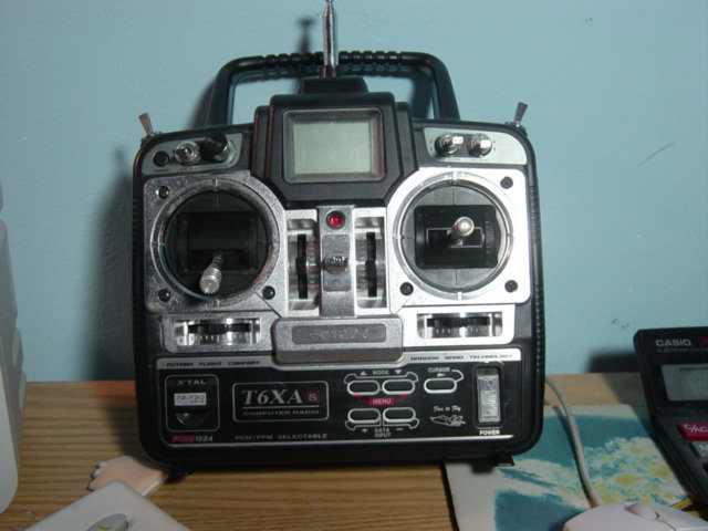

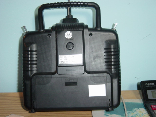

Good morning John
please look closely at the two pics
this will be the TX you hold in your hand while learning
I have heard that the CONNECTING END for the cable has been changed from round to square\
refer to the backside picture and look at the plug in the middle towards the top
see how it is ROUND ?
If the plug in your new TX is square
we will have to obtain a new cable that translates from the round to the squar plug
there is such a thing.
talk to me please. enough time till Sunday.

i think tower has the round to micro plugs
http://www2.towerhobbies.com/cgi-bin...?&I=LXBEK8&P=M

Thank you.....I used your advice and have sent off for the cable. Paid a little Xtra and should arrive here before the weekend. THANKS for being so SHARP
JOHN G ( ScienceisCool)
Don't worry about the cable. I have just purchased one from Tower and it should be here B4 Sunday. I already needed one of those to accommodate my own students.
Are you READY ?
RICK
Are you READY ?

Rick,
There is such an array of different connectors for all of the different brands and generations within each brand that it is hard to keep up. I wonder what it will be next week, maybe an infra-red port like on a keyboard or mouse. No, that is not a request if you mfg are listening. Oh, what have I done now??? [
You guys have fun Sunday, we'll be thinking of you and waiting for a report from both of you. No plastic bags!

rick, i have an adapter for that. it goes from round to square. it came with my real flight G2. i can send a pic later.
actually, if you have a sqaure to square maybe we could trade so i can use my new radio with my G2.

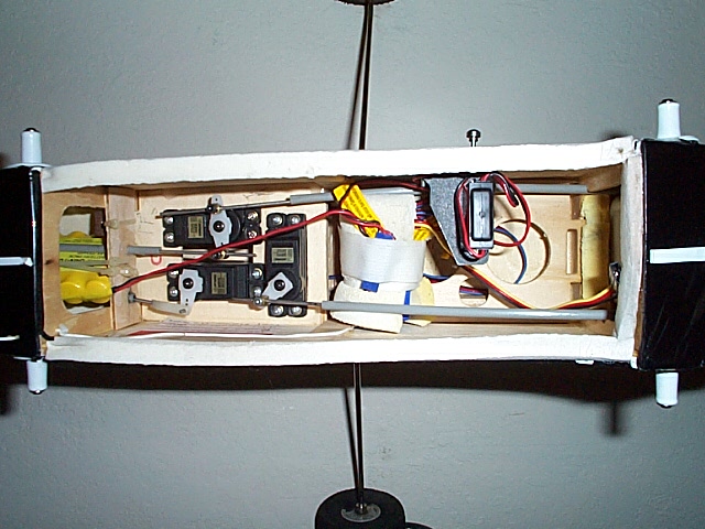

its alive.... ITS ALIVE!!!! i installed the electonics, adjusted them (for now) and my baby can sure wiggle! everything is ready for sunday.. just have to get through a week of work, waiting and waiting and waiting.
newbtorc, yes i have been informed about the rubberbands and thanks for the good advice.
