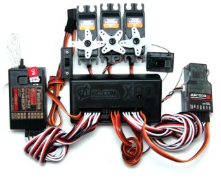

ORIGINAL: hookedonrc
Now there's an idea needing a manufacturer. A wireless buddy box...that's a concept I would think would have a market.
ORIGINAL: bruce88123
Rick,
There is such an array of different connectors for all of the different brands and generations within each brand that it is hard to keep up. I wonder what it will be next week, maybe an infra-red port like on a keyboard or mouse. No, that is not a request if you mfg are listening. Oh, what have I done now??? []
You guys have fun Sunday, we'll be thinking of you and waiting for a report from both of you. No plastic bags!
Bruce
The Wireless Buddy Box made by 2icrc can do what you are asking. You can use any two Txs from any brand using any transmitter technology (2.4, PCM , PPM, FM...) for buddy boxing.
Visit www.2icrc.com and read up about it.
The picture below shows the wireless buddy box wired to a Futaba PCM RX and a Spektrum RX. This picture only has 3 servos connected to the buddy box - so the picture doesn't get any more cluttered...however, you can connect up to 6 channels (6 servos) for buddy boxing.
Enjoy.
