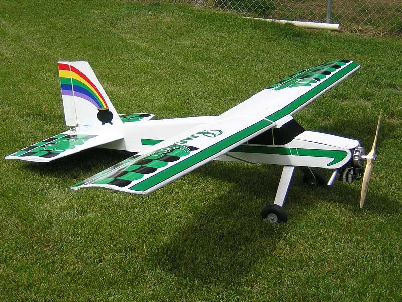

This 'SPAD' is quite a bit larger than what you are looking for, but I can fly it for 1 1/2 hours on one tank of fuel. The large C cell 6 volt RX pack lasts for 2 tanks, or 3 hours of flight time.

A Spad is not a light plane and that last post is a bit misleading until you read the build thread 35cc gas engine with a 52 oz tank,,thats almost 2 quarts,,,, on an 8 foot wingspan...you need foam or balsa a big ole trainer sized wing ...the dyna flite or piece o cake would probably be good...

Guys, guys, guys...SPAD's don't all build heavy. My Four Star copy is the same dimensions as a Four-Star, and only weighs 6 ounces more. And they don't all look like sticks. Pic 1 is the Cor-Star 60. Pic 2 is the twin version, and Pic 3 is the Biplane version. These are great planes for a tight budget, or for the guy who likes to build.
