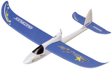

A much better model if you want to fly electric outdoors is the Multiplex Easy Star http://www.mft.nu/

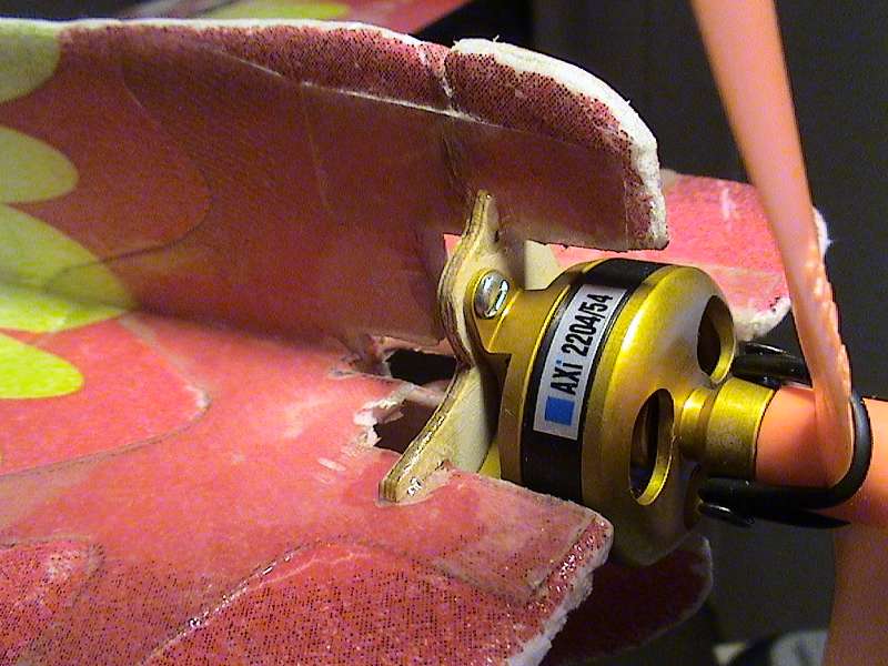

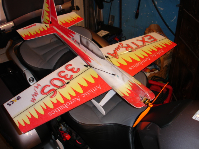

or any of it siblings. Or if you can fly well; a Shock-flier from Icarus (Germany) and the smallest AXI outrunner motor, 3 cell, 450mAh E-Tec lipo cell, 8x4,3GWS prop, 4,5g Diamond servos (German made), Jeti 5 reciver (Tjeck made) and Jeti jes 8-3p plus speed control (9g).This model weights just 150g (5-6oz) with the above servos, lipo cell and motor and is capable of all maneuvers.
