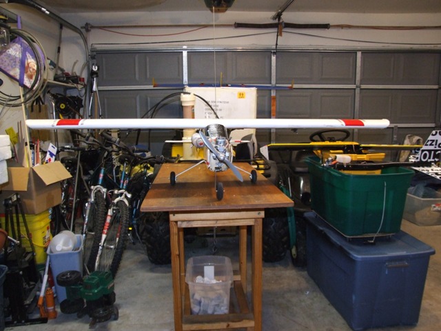

I learnt to fly on my NexSTAR and it did a wonderful job. I trained with the speedbrakes and wingcuffs on but the AFS off. After 2 weeks I removed the speedbrakes and 2 after that the cuffs came off. I have since converted it to a taildragger and removed the dihedryl from the wings. I fly 20 differant airplanes but I still find this one a relaxing flier especially with the mods done. The pic shows my NexSTAR as a dragger with the dihedryl still in. When I removed the dihedryl the plane rolls and flies inverted way better and handles wind a lot better also.
How did you remove the dihedryl? I just bent the rod in the wing and added 1/16 bass wood to the top part of the wing joiner. and yes it flys inverted much better and rolls instead of a corkscrew. I also added flaps.
Whats the benifits of being a taildragger? just preference?
[/quote]
I removed the dihedryl exactly the same way you did. But when I'm sure that I'm 100% happy with it this way I will reinforce the join with epoxy and make it more permanent and stronger.
Taildragger versus trike--- I found the NexStar ground handles way better as a dragger. Point her straight and throttle up, tracks very straight on takeoff. Absolutley no trouble taxiing in a crosswind. As a trike setup the plane wanted to wingtip in a crosswind--now--not. Also absolutley no fear of knocking the firewall out because of the nose gear AND a lot more prop clearance also. Very easy mod and I am 150% happy with the outcome!!
Curt
