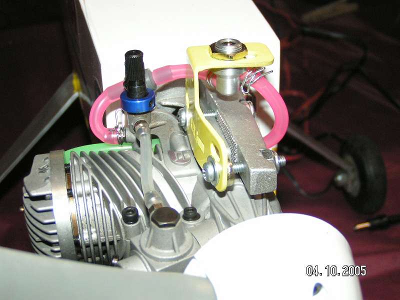

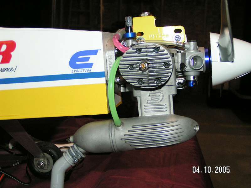

Here's the fuel system I set up for my Ugly Stick 40. I think it turned out pretty well.
ID:	256809   Click image for larger version
ID:	256810   Click image for larger version

Just wondering - what kind of mount does troyswan have there for the fueler valve?
I'm going to be setting up my first cowled engine. Plan on going with a valve type setup and remote glow and wondering how you actually mount them. Do you mount them onto the cowl or inside and just allow the hole to be the access point?

Looks like some kid of bracket he found somewhere. You could just bend one up out of some stock or you could send him a PM and see if it is anything in particular. Most likely it wouldn't work with your cowl. If your cowl is stiff enough you can mount directly to it, otherwise bend up a bracket of some sort to hold it just below surface of the cowl. If a bracket, it will need good support so it doesn't give too much when you plug in and have it bend and eventually break.

I'll be putting this on a H9 Miss America P-51 and the cowl is fairly thing. I was just concerned about it. The fueler not so much but the remote glow.
Old 04-19-2005 | 02:59 PM
Joined: Nov 2004
Posts: 11,703
From: Memphis, TN
Default RE: Fuel Line Setup
I would think that the same rule would apply, especially since ignitor will be attached during a vibration period. I think a separate bracket would be best in this case. Keep it short and attach to the firewall, if there is room, and it will look good.
