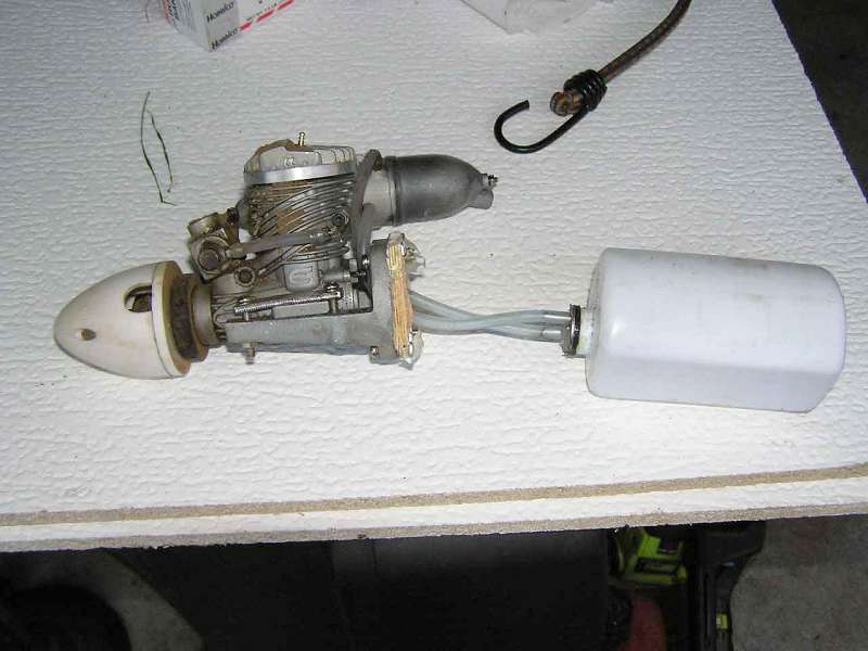

[:@][:@]Well, this was not how I wanted to show you how the new covering looks.
Yesterday I flew it for the first time, I had just replaced all the plastic clevis connectors with metal ones and as soon as I got in the air I lost control of the throttle, I flew it around at full throttle till I ran out of fuel and made a good dead stick landing.
Upon investigation I found that the clevis connector and the push rod were no longer connected the threads on the clevis connector just slid over the threads. I grabbed a new clevis connector and it seemed to thread on tight so I replaced it thinking I must have a bad connector.
Tonight I went back up, was doing loops, rolls if you want to call them that and I even did a bit of inverted flight. I was having a ball.
After 10 minutes I decided to do a couple of approaches, on the first one a throttled down and did a nice low fly by and gave it throttle to come around again. All of a sudden it went full throttle again with no throttle again. I took it up high to run it out of gas and do a dead stick. I finally ran out of fuel and started to bring it around. I'm not sure what happened but somehow I became disoriented. By the time I figured out were I was I was to low to bring it back so I turned it away from any possible neighbors and steered for the field across the street. Only problem is before I could try a long distance landing I lost it behind some trees. It ended up smack dab in the middle of a 400 acre field. At least it was a good job of getting away from the neighbors. Damn long walk though.
Again the clevis connector disconnected from the push rod. I checked it and clevis connector just slid in over the treads. About this time I am thinking I am raising some holy hell with the LHS and the manufacturer clevis connectors .
Just for giggles I tried putting the bad clevis connector on a new push rod, it threaded on nice and tight.[:'(] I don't know what to think now, other than I will replace the push rod and go back to plastic clevis connectors on the throttle
Damage, ouch. costly![:@][:@]
Looks like I lost the receiver and a servo. the needle valve on the Evolution is broke. The plane looks like a easy fix, I'll need a new firewall as that shattered.
Stick around for my next new way of crashing.[:@]

Holy eerie similarities Batman! I just had flashbacks to my Alpha crash when I saw the picture of your Evo motor with the innards strung out. Here's the picture from my crash for comparison...
Sorry 'bout the crash...not sure what to say about the clevises...
Using a metal clevis on a metal throttle are if that is what you are doing if a very poor plan as you found out the high vibration at that point will cause the threads to erode and the rolled seam to open imperceptably.

Did you put a metal clevis on each end of the pushrod ? That would be a no-no. Vibration will cause it to spin and back out of one clevis or the other. One end of the pushrod should be a Z-bend or something that can't spin around.
Many metal clevis have a seam right down the side (take a look). Now if you hook that directly to the the highest vibration point on the aircraft then the seam can open and threads erode.
Metal to metal on a throttle arm (that metal pin in a loose metal hole) has historically been responsible for more mysterious losses than you can imagine. Years ago when our Rx's had far less signal to noise selectivity, This was a major problem and no metal to metal was SOP. Any two pieces of metal vibrating together at high freqency will without a doubt generate noise (RF noise) that will eventually interfere.
Our modern Rx's while much more selective are stiil vulnerble to this noise when conditions are right. I have seen losses due to this constantly. When new student shows up with this setup that airplane does not fly with me untill its eliminated . Never use a metal or metal pinned clevis on a metal throttle arm.

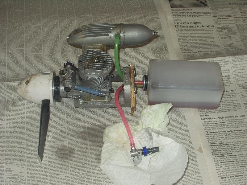

Good news on the damage. The receiver works, it turned out to be a broken wire on the battery. Lost one servo.
Every thing in the compartment came loose in the crash.
It looks like I will have to take the engine apart and clean the dirt out before I try spinning it.
What is the best to use for cleaning an engine. Any tips.
I think I will wait till I take it to the LHS first. That burns me, he knew I was a newbie. I asked him for help finding an instructor. If they were worth a darn they would have told me not to use these things on the throttle.

Many ARFs have metric puch rods that are a smaller diameter than a 2/56 clevis. The Clevis will seem to screw on but under load the rod can move inside the incorrectly fitting thread of the clevis as they are different sizes.
It is quite ok to use a metal clevis on the throttle if the arm on the carby is non metallic. The metal to metal of clevis and metal throttle arm is what causes the problem of RF interference.
When you say you have lost the servo did it go missing in the prang or is it nolonger working? Most often the gears are stripped and you can get replacement gear sets cheaply, much cheaper than a replacement servo anyway.
With regards to the motor what ever you do don't turn it over until you have stripped and cleaned it. Usually removing the carby and the back plate and checking there is not grit after washing in fuel or solvent and brushing with a soft small brush is sufficient. In extreme cases it may be necessary to fully strip down the motor. Don't just blow with high pressure air as this simply forces grit deeper into the innards of the motor.

WD40 which is mostly diesel is fine for cleaning the motor.

good to clean out the engine...

Did you get your engine running again? I cant find that part that holds the needle valve on the engine on Horizons site.
