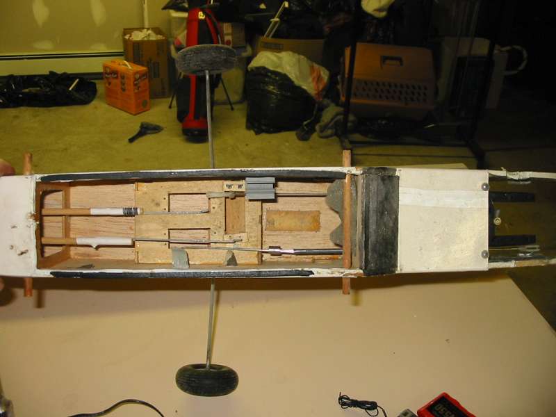

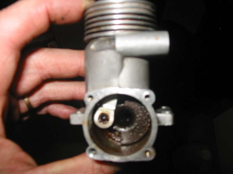

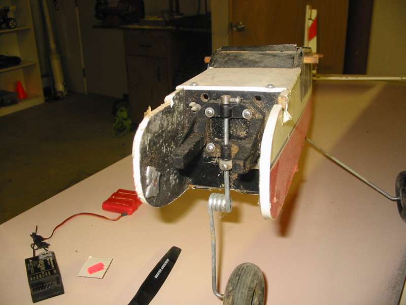

Hello guys!
Myself (an experienced nitro car/truck guy) and a buddy (zero nitro experience) have been given this basket case plane. The engine was completely rusted/siezed from lack of after run treatment. The plane is gutted and all the electronics are included. I have 4 servos (working) a JR century VII 7 channel rx, and a JR Max 4 radio. We ordered a new OS .46LA engine, and a new starter motor. I have soo many questions! Can someone hook me up with a good link for basic kit assembly? Heres some pics of our project. Is the break-in procedure for a new aircraft engine basically the same from car engines? Is there supposed to be a wheel under the rear tail of the plane (I don't have one). Any opinions about the .46LA engine, and my project in generall would be great. Thanks for your time!

Looks like you need to find a good flying club somewhere in your area. Since you have four working servos, that's a good start. You will have on e servo for the elevator, one servo for the rudder and nose wheel (both work off the same servo), one for the throttle, adn one for the ailerons (usually installed in the saddle on the wing). Since you havea nose wheel, you don't need a tail wheel. The 46LA will be a good engine for the plane. Make sure that youer on board battery for the palne is in good shape and takes a good charge. Usually I will just change out the on board battery with a new one to make sure. Make sure that you put the on/off swith on the left side of teh plane to keep it out of the exhaust stream from the engine. Most IMPORTANT - DO NOT try to teach yourself how to fly. Find a good club with a flight instructor (at 99% of the clubs, there will be no charge). Most clubs have enought flyers that would be happy to set up your plane correctly. Good Luck

There is a flying club that is very nearby to where I live. This plane upon close inspection is "weathered" but I figure we are newbs, so I would rather auger a "clapped out" plane rather than a new one. I can't believe how inexpensive aircraft engines are as opposed to car engines. I picked up a new OS .46LA for $79 !! your average performance .26 car engine will run $150+! When I look under the wing there is a recess for a servo? What happens in a hard crash with respect to the servo lead when the wing gets ripped off? Is there supposed to be a "nose piece" in the fron that goes around the engine? If there is I must be missing that cover. Will the plane still fly properly? Heres a pic of the front of our plane: Thanks again

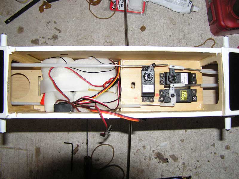

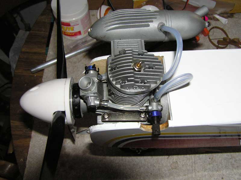

This is how it looks with every thing in place. There is no cowling (nose piece) on most trainers.

Polor Bus - a little Windex will clean that plane up. In the event of a crah, the servo lead will pull out of the receiver. The opening for the engine opening is correct, no covers needed. The airplane is designed to fly that way. The engine will fill the space. You might want to by a spinner to help out with a electric starter. Another thing about crashing - must instructors use a buddy box that attaches a "master" transmitter to your transmitter, the "slave". Crashes are much fewer using that system , as opposed to when I started flying and had the "throw the radio" trick to the instructor when the student got into trouble. Liek a couple of us have said, tak ethe plane to your local field and just ask for help - if its like most club, people will come out of the woodwork to give you advise!!!
