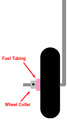

Skynyrd,
Use a small bit of fuel tubing between the wheel and the wheel collar to slow down. You can adjust the "braking" by moving the collar in to put more tension on the tubing.
Hope this helps

Good tip RCKen. I forgot the fuel tubing trick.

Do you have problems with the fuel line slipping out? Do you use something to attach the ends?

I'm not sure what you mean by "slipping out". The tubing is sandwiched between the wheel collar and the wheel. I've never had any problems with it moving.

Put the axle in the tube just like it was a fuel line from the tank. Don't wrap it around the axle.
