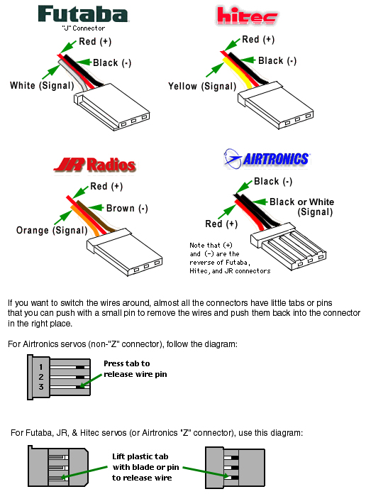

You can use any brand servo that you want to, you just need to make sure they are wired properly. Each brand of servo is a little bit different. Please refer to attached picture for wiring diagrams for different servo brands
Hope this helps
Ken
