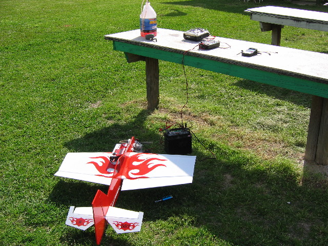

it ways little enough my bathroom scale wont measure it lol. ill see if i still have my flyweight scale.....
lemme try the pick thing

That is exactly the plane I was thinking of. I think my club member had a .40 2-strk on it, but if it is 3 lbs or less, you could use a .25FX or a .32.

a .40 on something this size? i dont think i could fit a fourty between the front forks
would a little motor like a .25 make for a nice slowflying model?

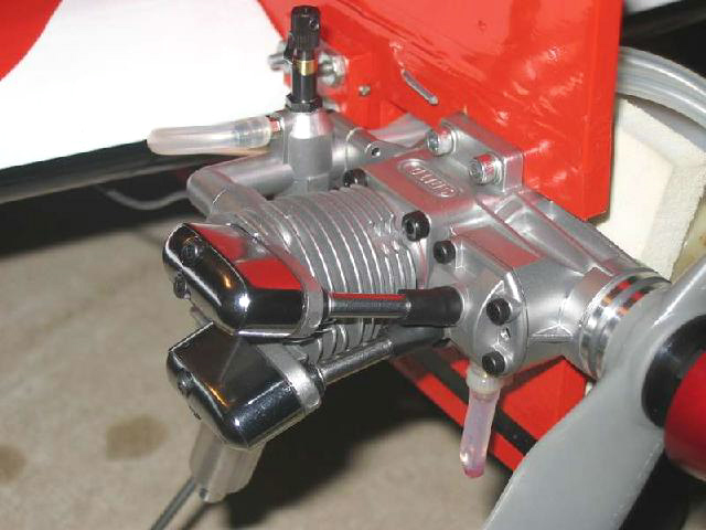

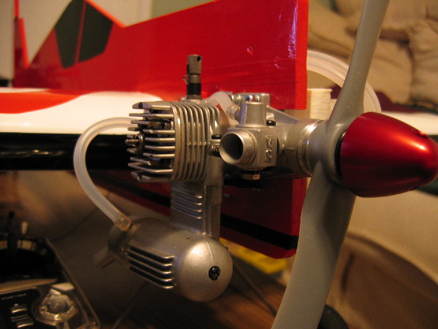

It is hard to tell exactly how big/small that plane is. From what I've seen it looks like a .25 would fly it nicely. A .15 may do it. Just not sure about the size. It all depends on the weight to determine what motor is needed. I've got a Fat Free Taco which is a .25 size profile that weighs 3 pounds. I have a Saito 40 on it now but had a .25FZ which flew it fine also. I wanted more low end torque for 3D. My WS is 36". Your plane should weigh less than mine, so a .25 would work great and a .15 should work. The version my club member had was larger. He had a .40 2-strk on his, but his was larger than my Fat Free Taco, so you must have a smaller version of the same plane.
I am using 5 micro servos HS-85MG instead of standard servo. 2 HS-85 = 1 standardservo in weight.

ah ic, this plane is about a foot long on the fuse and the three foot wing. i think ill try the .25 or the .15, because i want something slow enough i wouldnt have to go to the r/c field to use it.

That depends on the characteristic of the plane. I don't think it is going to float like a foamy, but you may be able to fly it around at a soccer field or baseball field at a park. My Taco can be flown at a small field, but still needs a good setup to land unless I am doing a harrier landing then little space is needed to land. It drops out of the sky like a rock when the power is cut/lost. Glide radio is terrible on the Taco.
Out of curiosity, please let me know the weight of your plane before you add a motor.

hi mate dont put a 25 on it!!,that plane looks ideal for a size 10!!.even a 15 would make it verry fast ,i have a mustang with a 40 "wingspan a scratch build that weighs 2 lb 12 ounces and has a size 10 in it.its plenty of engine so im sure a 10 would be a great choice for yours too.lmao at a size 40 been suggested my god a size 40 would be way too big for it!!.

The plane you have is a Fun-Bat from J&C Hobbies in Pittsburg,Pa. It is a .15 size combat plane. I have a new one in the box.
