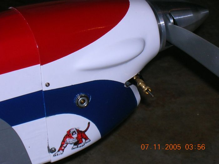

I have run many 2 stroke engines inverted and and have had no problems. Everything that I have flown had a cowling and I used a Super Fueler. Once the fuel tank is filled I keep the end from my gallon of fuel plugged into the fueler to keep fuel from running back into the carb. When I'm ready to start the engine I just fill the tank, unplug the fuel line, attach the Ni-Starter to your engine and fire it up. The low end on the carb does need to be leaned out a bit but thats just a matter of firing the engine up and let it idle, give it full throttle and see if the transition is good. If it hesitates to full throttle just lean the low end 1/8 of a turn and repeat this until the transition is good. I just finished setting one up the way I meantioned with a fueler and it's running a Super Tigre G90 inverted.
