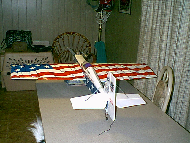

Here is my 1st atempt at using a heat gun.
