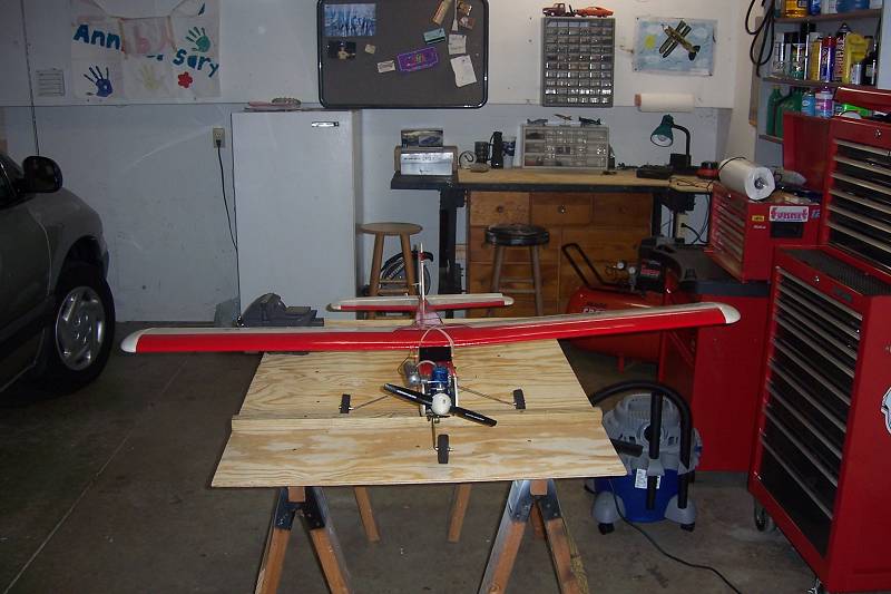

OK, I have been working on a gameplan on the best way to get started in this hobby. I have joined a club and I purchased a used Hobbico Avisatar 40 trainer this weekend for $125. You guys were right in all of your advice. I am going to steer clear of Guillows because I do want to fly them, although they make pretty nice static models. anyways in my adventures I am taking my time setting up this airplane to fly, I have started it up to get a feel for the motor and taxing it around the driveway to get a feel for the controls while it is on the ground. with wing off because I am too big of a chicken just yet. anyways on to my question I was able to find tech data on this aircraft as well as a user manual and it says the Center of Gravity is 3 1/4. What is the 3 1/4? also what is Elevator, Aileron and Rudder throw? also it gives 2 numbers High rate and low rate. for instance Elevator throw high rate is 3/8 up 1/4 down and low rate is 1/4 down. any explantions would be helpful or maybe you can direct me to a website with info such as this and other techinal jargon. Thanks for all your tips and ideas. It has made my entry into this hobby a bit easier and this site is a wonderful resource.

a picture of my trainer

HI Bill that center of gravity means you measure "Back" on the wings, from the Leading edge, the stated measurement .Yours is 3 1/4 " THAT is the point ,where you want your plane ,to balance..
The high rate :is when you activate ,your high rate switch (dual rate),, on your radio transmiter. NOT all radios have this feature.does yours.?.. Normally giving a larger total movement, of the effected control surfaces on the air craft.......When switched to high rate, you`ll have a greater Total movement, of those surfaces,than if switched to LOW rate
High rate is: 3/8" up, and,1/4" down, from it`s "neutral position"
LOW RATE: also up, and down, from your "neutral position",. You need to check your manual closer for the measurements .Your post only has half the specs in it. But it`s the same sort of principal as the high rate. I hope that this is, begining to make a little more sense to you now DAVE B.
P.S If your TX doesn`t have the dual rate switch, you can split the differences between the, low and high. suggested rates to have a happy medium.You`ll need to make those adjustments, on your planes linkages. I`m thinking though if the plane came with a radio and reciever that it would be already set up for you...A , BIG , BUT here, it is wise to keep an eye on these sorts of things and to check to be sure things are correct..AN awful lot of wrecks over this type of stuff D.B.
