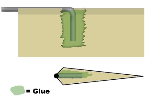

Not a big problem. Remove the covering and a little balsa from the top of the torque rod area and fill it up with epoxy or med CA (with accelerator), but don't fill it completely. Then, after it's cured, fill the remaining space with balsa filler and sand smooth. then patch the area with a piece of covering.

I haven't inspected the damage yet, but I thank everyone for the suggestions, especially the great diagrams (Minnflyer).

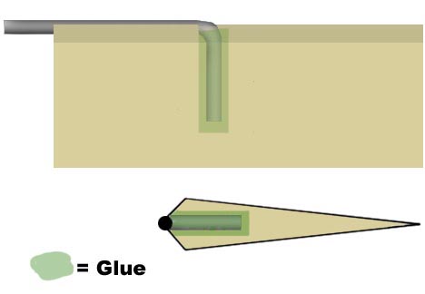

My pleasure. And since everyone likes my diagrams, here's another... (BTW Bob-NJ, I draw these diagrams with several programs, mostly, Photoshop, Illustrator, and Dimensions. All by ADOBE)
Here's a way to prevent this problem to begin with. When you drill the hole for the aileron torque rod, drill the hole oversize by a good amount. Then fill the hole with epoxy and insert the torque rod. This does two things, it allows for a not-so-perfect hole alignment, and it gives the rod a nice big epoxy "sleeve" to strengthen the area.
