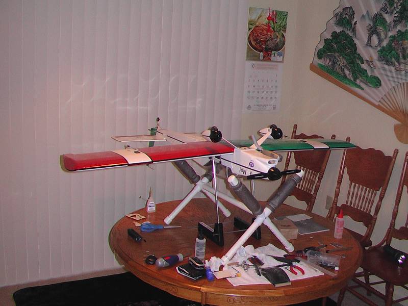

I agree that it needs to be balanced inverted. I just completed the kit 3 days ago and I only needed 2 oz in the noze to balance it out and that's with a balsa cowl, wheel pants, flying wires, tail dragger, etc (too many other extras to count). I've got the pics to prove it. The only con I could say is that the quality of the balsa and plywood in my kit was sub-par, but the way it flies far makes up for it. I've got a 46 AX pulling it and man it hauls a@#. Sorry about your experience.
Here's my thread:
http://www.rcuniverse.com/forum/m_3390094/tm.htm

Default RE: tiger 2 CG
yes the plane was balances inverted. Good looking tiger BTW. Interesting color scheme. Should be easy to see. I'm sure this one will fly great. Just a little disgusted with way it went together. Was too windy and I was too busy to fly it last wkend hopefully this wkend it will maiden
