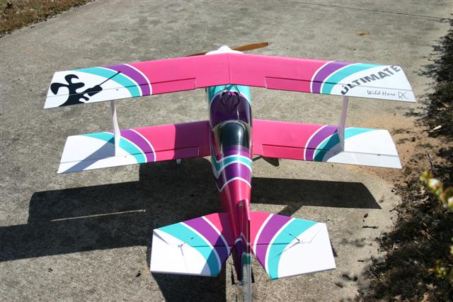

Here ya go
ID:	343417   Click image for larger version

Looks "Hare"y

Oh that smarts...You know the weird thing is that is actually a pic from Tom's website. I have my own but have not even taken them off the camera yet. I know I know, bad bad bad boy.
I do have a third one in the works and that's the GP Ultimate 160 and the SIG Hog Bipe, or as RCKen calls it, the SIG Pig ready for building when the flying season goes to heck in a few more weeks.
Hopefully Minn has his pics of his Skybolt still floating around, I know Ken has his of his Pig
