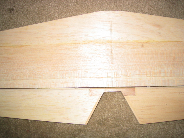

Here is my progress so far. I am using robart hinges instead of the ca hinges. A couple guys at my field suggested this. I also went with a hardwood joiner rather than the wire joiner that was supplies with the kit. I had several people tell me to do this modification. I worked just about every evening well into the night since buying the kit and I hope to never have to smell ca again. Are standard servos ok for a .60 size plane or do I need something a litle stronger?

Standard servos will be fine. Todays standard servos are better quality than the servos that were used when this plane was orig designed and they worked fine. You appear to have done a nice job on the Robart hinges, my favorite also.
Take your time and set the controls up for mild flight at first and you will have a lot of fun. Increase the throws as you get better with it.

As posted earlier standard servos are fine. I used an OS 61fx in mine. if you decide on a four stroke decide now it may be to late. after you get the firewall in. depending on what four stroke you may have to position the engine out to far on the mount. The only things i remember changing from the plans. was making it a tail dragger with Bruce Tharpe Ventur 60 landing gear and wheel pants. Along with a Klett 60 size tailwheel assembly. Along with using two aileron servos. Along with a canopy from sig that was about the same shape but has a lip on it. Did'nt think i could get the supplied canopy to stay on with the minimal gluing are. The control throws listed in the book along with the balance points are a real good starting point. Have fun
