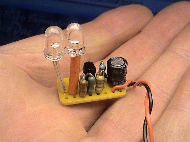

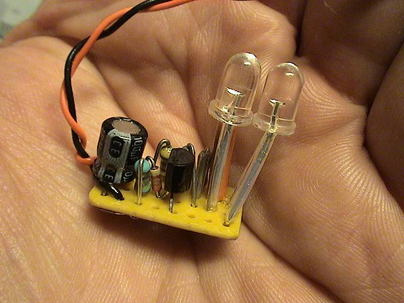

Hi!
Every one over here uses some form of diod checker. We mount them in every airplane we have! The left one in the pictures below has two diods ..one green and one red.
Green diod lights: means everything is alright, green and red diod lights...beware ...Red diod lights: do not fly!
At home I have a multimeter which I check the voltage on each cell when I'm not certain of the battery pack. 1,1-1,25 volt is OK, 1volt or under is not. I naturally do this with the battery under load (some servos connected)!
Regards!

Jan, nice tester, can you provide us the plans? it would be really nice. ive seen a lot of plans, but they are all very complexe with chips
your sounds simple, tks

I disagree with you. The first picture that Jan show us, will cost $2 US maximum. These electronic components, like resisters, leds, capacitors are really cheap. Of course, if you dont have a soldering iron, and this stuff, will increase the cost. But actually im a electronic engineer student, and i can have all these components for free. And.... im from Portugal. Shipping cost from towerhobbies is about $15US dolars, and will take more than a month to be here [
] That's why i really want to build one myself. Ive seen on the web lots of battery testers/indicators, but all uses OPAMP, and/or complex circuits[
] That's why it would be really nice to have jan's battery indicator plans. I tryed to discover the plans from the picture, but hidden components still a mystery[

Hi!
The two diode volt watcher is a commercial unit made here in Sweden and available in every hobby store over here...cost is around 10 dollars.
It works like this: When the green diode lights ...everyting is fine!...When both the red and the green diod lights ..watch out! ...When only the red diode lights...don't fly, Go home and charge!
A friend made a copy electrical circuit diagram for it a couple of yeras ago.
...I have not heard of anyone not using one of these in a plane for the last 10 years or so.
Regards!
