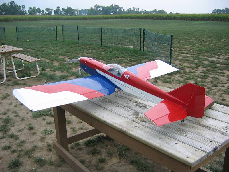

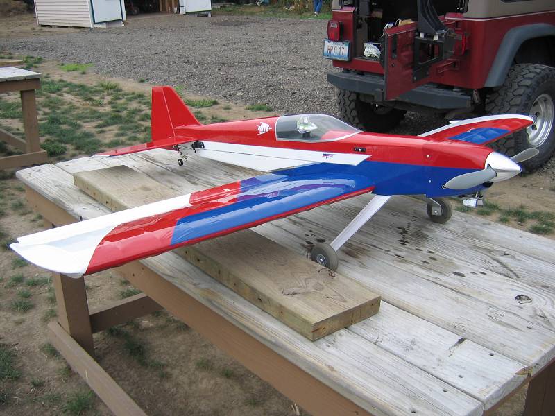

Well Mark,
This may not make your decision any easier but here are a couple pics of my BTE Venture 60. It is a very smooth flying plane. One thing I really like about it is it has very little rudder coupling which makes it very easy to hold a bunch of rudder during landings and use the ailerons to side-slip and quickly bleed off altitude without gaining a lot of speed. This looks really cool!
It's best maneuver is probably the outside snap while in a high-speed upline. Doing this will send it into a weightless tumble that is loads of fun. The wood in the kit is simply perfect and the way the parts are manufacturered is actually superior to lazer cutting. Not a single burnt edge to sand. Sig kits are very nice but Bruce's quality is even better!
I did do a few mods on mine which include clipping the wing one bay (I wouldn't want my wing any longer after flying it for a few months.) You'll also notice from the pictures I made a custom fiberglass cowl for the nose since this was the one area where I wasn't crazy about the looks.
If you will be flying off of grass, definitely move your main gear a bit forward from the stock location. Mine is very light in the tail while taxiing. It is easily managed by holding up elevator but it is a little too light in the tail for my tastes. I will probably move the gear a bit forward when I find the time. I think Bruce now even recommends this on his web site.
Good luck!

FlyerBry, Very nice!! I too don't care for the open engine look, your cowl cleans it right up. Nicely done, I was hoping to be able to get some kind of cowl to fit as well, unfortunately I don't know how to work with fiberglass, but I'll get someone to make one for me. By the way, I have allready decided on the Venture, even if it means waiting till X-mas to get it. Sounds like you're having a blast with yours. I'm glad it turned out so nice for ya

Thanks for the nice compliments guys... My Venture is powered by a Saito .82. I kicked around the idea of putting a Saito 100 in it but I was afraid the weight difference would be too much. Keep in mind this thing builds about a pound lighter than the 4 * 60 so an .82 should be equivalent to a .91 or 100 on a 4 * 60. Also the fact that the .82 is as light as the Saito .72 keeps the plane a bit lighter.
I decided not to use the stock pushrods and put the elevator servo in the tail with the rudder on a pull-pull setup with the servo located under the canopy. For the ailerons I put separate servos in the wings instead of a single centrally located servo. I don't see how using the stock setup with all the servos up in the fuse between the wing saddle would cause any problems - I just set mine up using my preferred setup. It works well and I am very happy with it.
This is a great second or third plane and even would make an excellent choice as a first kit. I have a 4 * 40 kit still in the box that I bought to take pylon racing and after looking over the instruction manual I'd say the Venture is a little easier to build of the two.

FlyerBry,
I see that you installed your engine inverted. It looks great that way. I am currently building a Venture 60 and am now trying to decide how I want my engine installed and creation of a cowl. I was originally going to mount it sideways, but really like the look of the inverted engine.
I have the same engine as you but am concerned about the inverted position relative to the tank position. I have read in numerous locations that the centerline of the tank should be at the centerline of the carb. It doesn't appear that I can position the tank low enough in the fuselage to accomplish this.
What did you do, and do you have any problems starting the engine or having it run lean/rich when flying inverted?

Dave,
The tank position is actually very easy. I mounted my tank in the bottom of the fuse. Insead of installing the horizontal tank support piece in the stock location I installed it in the top of the fuse above the tank. It only took some minor trimming of the tank support piece to fit in the top instead of the stock, bottom location. I suppose the support piece could be left out entirely but I felt it may add some structural stiffness to the nose so that's why I chose the alternate location.
The Saito runs great inverted. The only drawback to it that I see is getting the glow plug hooked up on the flight line is a bit of a chore but I think the looks are worth it. I considered mounting sideways as well but with the fiberglass cowl you have to do the least amount of cutting of the cowl to get a good fit if you mount it inverted. I wasted more time deciding on how to mount the engine than anything else on my Venture. Now that it is done I'm happy with the results.

Thanks for the info FlyerBry!
You've convinced me. I'm 99% sure I'll also mount my engine inverted. Although I won't be making a fiberglass cowl. I am figuring on using balsa to "fill in" the upper and lower part, while leaving the stock cheeks in place.

Happy to help. I considered the balsa cowl route myself. If you do some searches on the Venture I recall there being some posts where others have posted pictures of doing a cowl in balsa. I probably would have done it this way myself if I left the engine upright. I couldn't make up my mind which way I wanted to mount the engine (sideways or inverted) so the fiberglass cowl gave me more flexability to change my mind up to the very end. Either way will look much better than stock.
It sure would be nice if Bruce would get one of the fiberglass companies to build cowls for him that he could sell with the plane as an option. I would have had my Venture in the air much sooner if the option were available.
