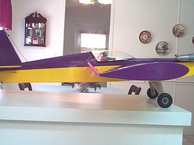

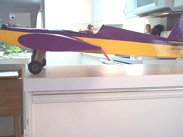

Hi dsk
I have the same airplane and radio and went thru some of the same problems. I happened to bump the knob to full up one day on takeoff and ran it full throttle for over 150 ft before I realized what had happened !!! The tailwheel never even came off the ground LOL. Also tried throwing full down flaperons on it at about half throttle, I could make it do outside loops using no elevator at all. I am checking with Radio South to see if they can install a three position switch in mine and do away with the knob. In my opinion Futaba should have put a switch on it to start with.

Hi daboosailing
Let me clarify on my previous post that I had the flaperons in extreme throw conditions !!! ( 65+ degrees) and throttle set to half or more !! See pics below. Under normal conditions and using the flapperons normally 10 to 20 degrees and 1/4 throttle or less you will not see these large nose pitches. Yes down flaps generate lift but huge amounts of down flaps and excessive speeds with no elevator opposition will cause the ailerons to act similar to an elevator and they will try to lift the trailing edge of the wing similar to an elevator lifting the rear of the plane, thus causing the pitch down of the nose. Also the SSE has a very wide wing chord over 12" on a 24" wing half and very large ailerons, wings with a smaller chord and narrower ailerons should not pitch as much. At full deflection my ailerons are trying to act like a speed brake. Please excuse the long winded explanation. This was the easiest way I could think of to explain it and I am sure one of the moderators will tell me if I got too far off base.

There are several things occurring in this case.
The extension of the flapperons increases the effective angle of incidence (and effective AOA), which increases the lift. However, in this case the flapperons are extended well past the point of maximum lift, and drag is increasing much more rapidly than lift. This being a low wing AC, the center of drag is now pushed downward, well below the thrust line and center of mass, resulting in a down-pitching moment.
There is also a contribution from downwash that is probably approaching the lift from pressure differential -- thus pushing the center of pressure aft & making the AC nose heavy.
Had the flapperons been extended at a much shallower angle, the pitching moment would have been upward.
Overextension of flapperons is highly dangerous -- it can cause extreme adverse yaw and aileron reversal, in addition to nose-down pitching in a low-wing AC.
