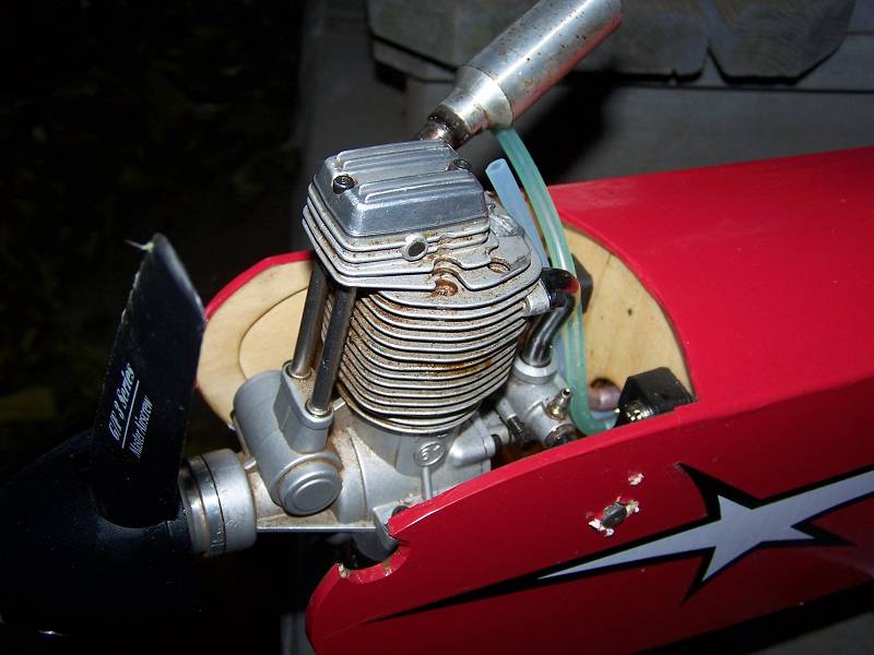

Hello I put an OS 61 four stroke on my second airplane which is a Sig Four-Star 60 The engine starts easy and and runs great the problem I am having is when on the ground I set the idle so the airplane doesnt move until i throttle up. Then after 10 or 15 min. in the air when I come in for a landing the idle is way to high so I have to kill the engine and land dead stick in order to land it. I have checked the linkage and it is tight this happens ever time I take off any ideas what is going on?

Possibly the engine is not up to running temp before take off or may be a little hot (too lean) and this will cause it to idle higher.
Try getting the engine up to a good operating temp and then set the idle again before take off.

Hello the engine runs great in the air but after a loop it does cut out for a second then runs good it has never dead sticked on its own I will try the warm up thing and give it a try. And as far as the OS 61 powering the four-star 60 it has more then enough power not a fast plane but lots of power for a newbie like my self rolls and loops great and can climb great im running a 11x7 prop but going to try an 12x6 next time I go out

If it's trying to cut out during or after a loop then it is too lean and if you leqve it like that you will ruin it. To properly tune a four stroke you need a tachometer since you cannot hear the engine change rpm
BUT, I just realized something, I was not aware that OS made a 61 sized four stroke. Currently they make a 30, 40, 52, 70, 91 and a 120
Are you sure it's not a two stroke OS61 which they do make
It's easy to tell, there will be a black valve cover on top of the head, it's almost exactly square in shape and is locate right in front of the glow plug. Pictures would really be nice or tell us any marking you see on the engine

If it is indeed a two stroke, then that makes sense--two strokes take a lot longer to spool down than four strokes. You have to back off the throttle much sooner when landing a plane with a two stroke as compared to a four stroke!

Ok yep it's a 4 stroke and I found it on OS's web site but the manual was not available so I cannot recommend a prop.
I would start by tuning it. You will need a tach.
Start it then take it to full throttle and richen it until it starts to run rough. Now start to slowly lean it out, using the tach, until you get max rpm and turning the needle no longer changes the rpm (do not go past this as you can cause it to detonate and throw the prop so do this from behind the engine). Once you get max rpm, then richen it until you lose roughly 300 -400 rpm and leave it there.
Now bring the engine to idle and let it sit for at least 1 minute, 2 minutes would be better. Then quickly bip the throttle to half way. If the engine stumbles and spits allot of smoke the the low end is too rich. If the engine stumbles and tries to die or starts to detonate without allot of smoke then the low end is too lean and quickly return the throttle to idle. If the engine instantly transition to half throttle then leave the low end alone.
If you have done all of this and still get the same problem then start looking for air leaks from inside the tank out to the carb, including the "O" rings on the needle valves.
Oh yea, also check the valve clearances, they may be in need of adjustment.
