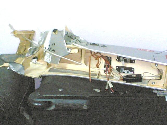

Hi there all,
Its been a while nobody has posted anything in this forum, nothing's been replied or posted. Well, I have to post something and Im doing it. As I re-assembled my P51 Mustang from H9 and started it flying, and it flew it very well, but since I bought, from the start I had left aileron not responding not moving due to little loose connection of extention, somehow, it flew well before last sunday, but left aileron didnt respond and 2 times it was saved from being crashed, as I had to call senior flyers and they landed it. I fixed the aileron mechanically and last sunday it flew very well, and I landed it perfectly. As I told from the start as left aileron and right aileron servos are connected with extension wire then connected to Y-harness, second flight I did and it took off very well, as it was gaining height, it took a quick left turn, and started diving on the left side and I gave right aileron, it didnt respond so it took a nose dive and crashed[&o][&o]
. I didnt even have chance to recover it, as it didnt gain much height, I have lost my Mustang, a friend of mine told me to send it to me, and I would get it repaired, I hope it is done. Rest its a part of this hobby, I hope to hear from you all.
Mody
Some of the wreckage pictures

That's a shame Mody. We know how much you valued that model. It looks repairable with a lot of work. Get your trainer fixed & back in the air as well.
Commiserations & good luck

Brit, I dont think its a shame, well, it was not my fault, well, first im worried about my engine to be fixed, infact needle valve is broken, and it needs to be fixed, as I have given it to my friend so he is gonna do something about it in couple of days. Well, yes mustang is repairable another friend of mine who lives nearly 1,000 milesaway, i gotta send it to him and he told me to get it repaired, well, as soon as my engine needle valve is fixed, Im gonna fix back my high wing trainer, it needs a lot of work too, specially to put new plastic mount for the engine. One more bad thing happened is Rx is not working, i checked batteries, when I switch on the Rx servos just make a little jerky movement, when I turn on the Tx and try to check if servos are working nothing responds, my radio is doing good on the simulator, may be Rx's crystal is damaged as well, Im gonna get it checked as well, otherwise, bye bye for a long time. Yes I valued that plane, but its a part of that hobby and nobody can be so sure and confident about not making any crash whether its human error or its electronic or mechanical.
