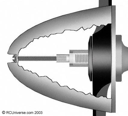

OK...I have a Supertigre .40 with 1/4 shaft. I am working on my 4th prop and still can't get this right.
When I place the spinner back-plate on the shaft, there seems to still be about an 1/8th of the unthreaded portion of the shaft exposed between the back-plate and where the threads start. I am using a Zinger Wood prop and the problem is that the prop fits very snug up to the point where this shaft is unthreaded. This is as far as it will go unless I ream a portion out to make the prop fit snug against the backplate.
Should I ream the prop out by the 1/8th inch to allow it to fit snug against the back plate??
I am afraid if I try and force it on the larger portion that I will break the prop.
Any help would be appreciated.
Also had the same issue with Master Airscrew props.
Lamar

OK....I have a prop reamer and have reamed just enough into the back side of prop to make it fit. I was afraid that this would weaken the prop by only doing a partial ream. Guess it's just beginners jitters or something.
After I reamed it partially, I rechecked the balance and everything seemed good.
Has anyone ever tried the Du_bro metal Prop Nuts?? I am assuming that if you use one of these in place of a plastic spinner you can eliminate the backplate??
Also, how tight is tight when you tighten down the prop nut onto the shaft. The last prop worked itself loose...no damage to the plane but it did happen. Can I overtighten and damage the prop??

The ST's are a bit tricky because, while they use the usual 1/4"x28 thread, the plain part is actually 7mm (1/4" is 6.35mm) so if you're going to ream it properly you'd need a metric reamer. I just run a drill through far enough to give a clearance. If you use a tapered reamer then the prop is located by the threads which is no biggie because the threads are very accurately cut. A lot of props (APC, Master etc) come with the back end already more than large enough to fit over that plain section. All wood props have a plain hole (usually 1/4") so they definitely need to be opened out at the back.
I'd better add that with a wood prop they need to be tightened firmly but don't overdo it. And recheck the tightness fairly often because the wood will compress for a while and the nut will be looser.
