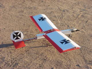

Just finished this trainer. It is a mix of a spad debonaire an aluminum tail boom and a stik design. Flys great. Tommy

Be carful with those spads, There so cheap and rugged there addicting, I have 2 already (a Deralict and a Spazzler) and I just put the maiden flight on the Spazzler and I already have plans on building a S.P,A,Demon. They fly good and cost about $12 each.... I can't stop building them.... Yours looks good and spads make great trainers too.

Very Sweeeeeeeeeeet airplane Tommy! Great job and thanks for showing it off!!! Is the tail boom made from "U" channel? I've been looking for some but so far I've found either "L" channel or it's too big. I'd be interested in where you found it!

I have an Armidillo, somewhat similar to your plane only not as purty! Has anyone had any experience with the Spad plane called the Sickle? I found one as an ARF but only available in Scotland. Thanks

I used 1" aluminum u channel I found at our local hardware store. The nice thing about it is that the servos fit right in the channel and by connecting the boom with small butterfly nuts I can remove the whole tail, servos and all in about 30 seconds. The servos line up in a row making evrything very easy. I can't take credit for this as the duraplane gave me the idea. Tommy

Thanks Tommy! I'll be checking ACE and True Value this weekend!

Right on! Thanks Tommy, I found the aluminum channel at ACE hardware less than half a mile from my house Now I have a bunch of new ideas because there are all kinds of shapes and sized of the stuff!
BTW, I would like to commend you for the great combination of ideas you put into your trainer!
