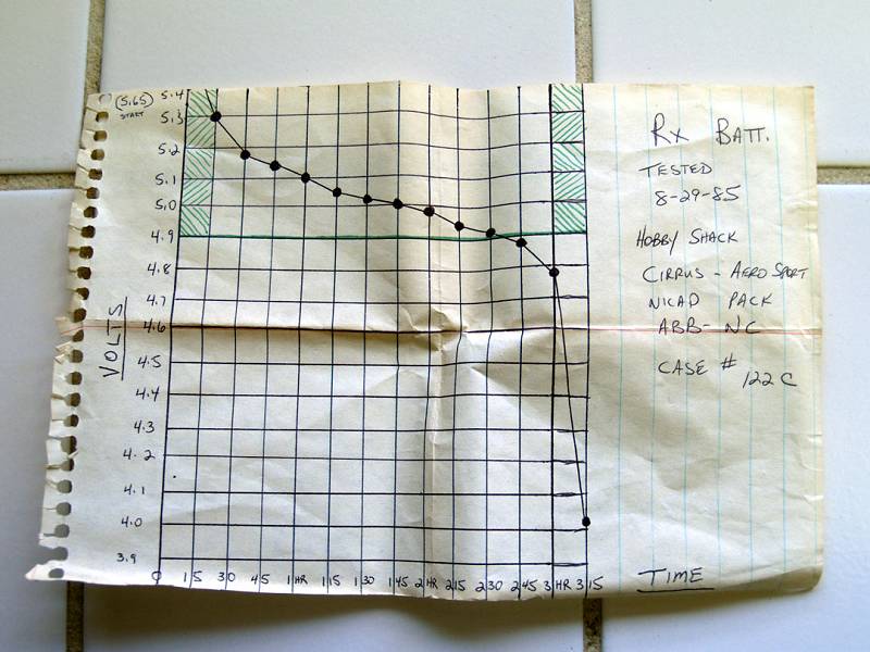

cool pool: You do not need anything fancy, or computer operatered, or whiz bang to get the info you need.
All you need is some time and an attention span.
When you get an ESV, make yourself a chart, and record the voltage levels every 15 minutes. That way you will know how long your battery is good for. This is the way we did it back in the dark ages.
