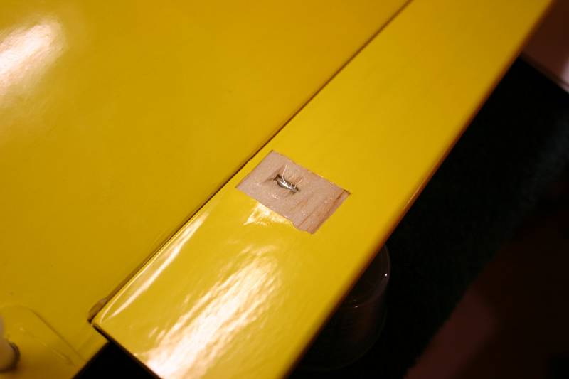

Hello everyone......Could anyone share advice how to remove an aileron w/CA hinges?? I need to remove my left aileron on a Sig 4* to better secure the wire aileron torque rod. This rod has developed a good bit of play (up and down) and I need to reglue it back into the wing. The only way I can see to do this is cut the hinges into and then recut the slots once I am ready to reinstall.
Or should I just purchase new ailerons??
Thanks in advance.
Lamar

here is a tip so you dont have to remove the aileron at all if you can locate the rod in the aileron you remove the balsa on the bottom side with a hobbie knife and fill the void with 6 min. epoxy to avoid the hassle of re hinging and you will be flying in 6 min. not sure what the knock on ca hinges is the work fine as long as you dont over glue them so they become brittle. used this on my NEXTAR after the rods loosened up worked perfect still tight if you want to cover the clear epoxy iorn a small patch I didnt

OK...I removed the covering directly over where the aileron torque rod goes into the aileron. The balsa has been torn away exposing the rod...no wonder I had play in the aileron!! Now I am trying to fill this hole with think CA. Do you think it will hold up under the stress of the ailerons in flight??
Not sure....

It may, I'd rather see you use epoxy. Harden the wood with a couple drops of thin CA and then use epoxy to fill the hole.

The torque rod is in a tube right?
If I were you, I would think awhile before using the CA. It can work but you better be very careful to insure it doesn't migrate to where the rod comes out of the tube. (How do I <grin> know this?) Epoxy is a really good glue to use sometimes instead of CA. It doesn't wick off places you don't want it to go.
But there is another thing to look at. If the wood right over/under the torque rod wasn't strong enough, then the wood to either side might not be strong enough to hold the blobs of CA for very long. You might just wind up with a torque rod with blobs of glue working up and down. Look at the whole area the rod is in, at the wood and try to figure out if you think the wood surrounding the rod needs to be strengthened. No value to doing the job and needing to do it again later.
And now........ let me advise against my first advice..... chuckle..... yeah, you might actually want to use some CA to strengthen the wood thats not directly in contact with the rod/tube. But be very careful where it can wick. And thin CA works best here, but of course it's the "wickingest" CA there is.
The best advice isn't always the simplest advice....

Ok...got it
The rod is really exposed or at least the half of it (end pointing into the aileron)
I have just applied the thin CA. Next I will try the 6 minute epoxy.
thanks
Lamar
Old 01-18-2006 | 05:05 PM
Joined: Oct 2005
Posts: 30
From: Nashville, GA
Default RE: Help with Aileron Repair
No...No Tube!!!
The wood appears to be ok on the top side of the aileron as well as to the left and right. I am including a couple of pics for you to llook and see what you think.
I have already placed the thin CA on the wood and into the cavity. Gonna hold on the 6 minute Epoxy until we see if this is really what needs to be done.

This can happen sometimes if you don't get the hole drilled exactly down the center of the aileron or if the hole is drilled too deep. Also if the aileron is "twisted" on against the linkage. Heck, it's just balsa. Whenever you drill one of these holes and are satisfied with the fit, go ahead and "toughen" it with a little CA. Let it cure well before putting the linkage back in the hole. You may need to freshen the hole with a drill afre the CA.

Do you think the Epoxy will hole the rod after looking at the pic??

Use 30 minute epoxy mixed with microballons to fill in the hole you have there. Don't worry if you don't have microballons on hand, you can substitute corn starch and it will do exactly the same thing. First of all, secure the aileron in the center position. And also make sure that the torque rod is centered too. Mix up the epoxy and mix in the cornstarch/microballons. Fill the hole with the epoxy mix, make sure that you work the mix all around any gaps between the torque rod and the wood of the aileron, and then let it dry. You can then sand the epoxy smooth with the aileron surface and recover the area with covering material (monokote or ultracoat). I've made several repairs like this before they will hold up just fine in flight.

with the small amount of filling needed dont trip on micro baloons just make sure the rod is covered in epoxy looks like your channel needs to be a little longer not any wider. cut it to the edge of the aileron hinge side so you secure the rod fully if you don't bury the rod in epoxy you might get some loosening again after your repair. as noted in my post I only flew my plane a few times before the aileron started flapping I think its just ARF sloppiness I think mine wasn't glued in either
