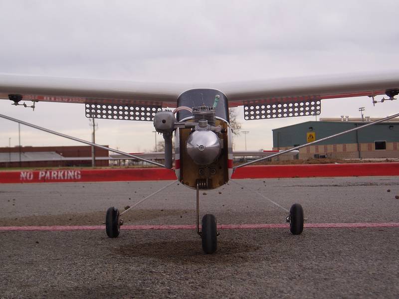

Joined: Oct 2005
Posts: 27
From: Roanoke, TX
Default RE: Exhaust hole position?!
This is what I have done to my Nexstar to minimize the slime effect. I used RTV sealant in the muffler to eliminate the rouge exhaust leaks. Works pretty well, but I still get some slime toward the rear of the fusalage. I'm learning to live with it.

You could replace that deflector with a long piece of tubing and attach it to the tail so all the exhaust will go behind the plane but you might loose some power

When you are adding on to your exhaust remember that nothing is free. What I mean by this is that when you add on to the exhaust you are creating more pressure inside of the exhaust system. This increased pressure will cause a loss in power of the engine. How much loss? That's hard to tell, it could be so small that you may not notice or it could be quite a lot of power lost. All I can say is to try it and then see how the plane performs. If it's still acceptable power levels to you then keep the exhaust extension. If not, remove it.
