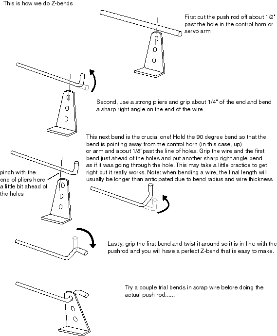

Anyone have any ideas for slipping pushrods.Ive tightened the set screw as tight as I can in the push rod connecter but the rod is still sliding

I think it's likely you are trying to secure a push-rod that has a diameter which is to small for the connector you are using. I asume you are using the EZ Connector type connection. Replace the connector with the proper sized connector for the push-rod your trying to secure, or go up in diameter with the push-rod.

What Mode One said. Or you can remove the EZ Connectors completely and put Z-bends in your control rod. This will eliminate all slippage. Use the attached diagram as a guide for making Z-bends in your control rods.
Ken

Personally, I wouldn't use EZ type connectors on control surfaces. Use a Z bend at the servo arm and a threaded clevis at the control horn.

If you've found problems with this type of connector, it seems to me that's a good recommendation to not use them. A Z bend and clevis works 100% of the time, with no modifications, and no slip or slop.

Actually, I had the top of a Z bend break on me before. I was using it on an aileron. The "down" portion of it was still stuck in the servo horn, but the second bend had broken off. I cought it before I took it up again. Thank goodness. I got one of those pushrod connectors that you use on the 90 degree bends--ones that slip over the wire, and then clamp back to the wire. They work very well too, and it saved me from having to make a new pushrod (I had it at the field at the time).
Granted, this is an exception rather than a rule, but I have had a Z bend break. I have not, however, had an EZ connector break. However, I too refuse to use them on control surfaces--just throttle. I figure that if I had used them on control surfaces, I probably couldn't have made that last statement.

Me too, while I was installing them. The material used for some pushrod wire is very brittle and does not accept 90 degree bends very well. When I encounter this I end up replacing the wire so I can get a proper z bend without cracking the wire.

If the top of a Z-Bend can break, then the bottom of a Z-bend can break! This would mean that a simple 90 degree bend can probably break as easily! This is not a good scenario!! We are talking about a "Work Hardening" of the material in the location of the bend. Some push rod wire, seems to be harder then it needs to be and the action of bending further hardens it. The less bending which is done, the better. This wire is also capable of being annealed (softened). You can tell the difference between harder and softer push rod material as the hard, is much more difficult to bend. The annealing process is a simple matter of heating the material and bringing the metal up to a "Straw" color (this is just previous to the metal turning blue) and dipping (quenching) the material in some type of oil. Given that there appears to be harder and softer pushrod material from different suppliers, find one that has softer material and stick with them. This makes me wonder if manufacturers are unaware of this potential problem! (This information comes form 25 years in the manufacturing trades and 22 years as a tool and die maker).

When bending piano wire, you have to start the first bend, maybe 60 degrees, back off the pliers a bit then bend to 90 degrees. It's the sharp bend that fractures the wire. Make it a more gradual bend, and it won't break. Haven't broke a Z bend in 50 yrs.
