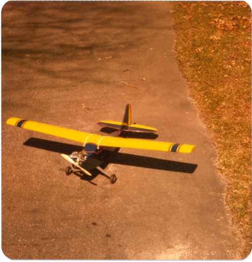

PS. the plane in the picture is what I learned with, a Sig Scamp. Very non-traditional, but it flew great. They no longer make them, but I recently acquired a new kit. When I finish a few other projects I'll build it.
