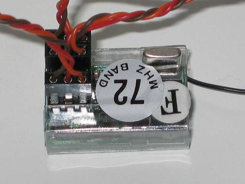

Sure enough, I smoked another tiny electronic device. Perfect.I tried using the on-road gas car receiver pack to power up the system just now, and actually had the rudder and elevator on the Mini-max responding, though it seemed a Chineese puzzle as to which channel was which and which stick on the Futaba Conquest TX was going to operate which surface. I thought I knew which bay on the receiver was for the speed control, as I could see the left stick (Which I think is to be the throttle) was running one of the two servos.
Connecting the speed control to the appropriate spot on the receiver did nothing, and I was trying to enable the "safe-start" circuit as per directions. In any case in one of the several connect/disconnect cycles I saw a spark in the receiver and after several more fruitless attempts where nothing happened I suddenly got a definite little arc in the little sucker.
I was obviously trying to keep pos/pos and neg/neg where there are just the two, but I still am not certain as to the white/red/black orientation.
I got out a standard receiver and used a standard 4-cell AA pack and the new little servos are fine; the speed control is a question mark and I suspect the receiver may NOT be a question mark.
I wish to crap I had one of you guys here who knows something; my retired teacher buddy who knew LOTS in an intuitive way about ham radio and simple electronics had the misfortune to die two years ago so I don't have anyone on the local scene who knows or cares much about electric RC planes!Thanks for any info. Glen Priest

I have mine here in my hands now...
1 is ailerons
2 is elevator
3 is throttle
4 is rudder or batt
Above those numbers are S + -
If you turn it over now so the crystals side is facing you the top pin is signal ( white wire ) the middle is pos ( red wire ) and the bottom one is neg ( black wire )
I suspect you got the servos connections right, but you got the speed controler opperation wrong.
When you want to use the controller to power the motor you dont pulg the main batt into the Rx, you plug it into the speed controler like i mentioned below. there will be 3 sets of wires, the wire to the Rx is ovbious, the other two normally have 2 pin plugs on.. the bigger red female one is for the batt, the black female one is for the motor, at least it is on my GWS control.
If you pluged the batt into this it would have droped the power and all would be happy and safe, i suspect you still had the batt in the Rx and it tried to draw all the power it wanted though it.
IF!!!! your lucky all you've done is break the track between the + or - pins on the Rx as they are not designed to cope with this power.
if you look closely you'll see all the + pins are joined and so are all the - ones, see if theres any break in there, if there is, resolder the joint and you might just get lucky and have a working Rx again.
The rule is, if you have a speed controler, thats where you put your flight batt.

I have one of the Electrifly C-10's. I also have one of the GWS 4-ch RX's.
If using a Futaba TX: (and a Futaba comptible verson of the GWS RX... there is also a JR compatible version)
Ch1 is right stick side-side.
Ch2 is right stick fore and aft
Ch3 is left stick fore-aft
Ch4 is left stick side-side.
OK... you have the picture of the RX above... He's using JR servos by the color code. Orange on JR = white on Futaba. Brown on JR = black on Futaba. Red = red. Plugging the battery in backward = smoke.
The C-10 doesn't like less than 6 cells when yuo try to operate a motor. It SAYS in the instruction you can use 5... but it may refuse to turn on the motor. It will power up the RX OK on 4 cells.
First you have to determine that its all plugged toghether correctly. The red and black for the battery powering the ESC are the traditional + and - (and are moarked with a + at the red wire entering the ESC circuit board. It says Batt pretty clearly on the battery end... and motor clearly on the motor end. The plug for the RX is color coded normally for Futaba.
The motor can be temporarilly be replaced with a 12 volt light bulb from a car tail lamp while testing the ESC and RX. (mo worrying about the plane getting away from you)
Turn on TX, THEN turn on the power to the ESC (plug in the battery) Move the TX stick and trim to maximum. Pause a couple of seconds. Pull the stick and trim to minimum... listen for 3 beeps. (no beeps? put it back to maximum... it should beep) move the stick and watch the bulb grow brighter as you move the stick more.
You HAVE to cycle maximum, pause and then minimum and wait for the beeps or the motor WILL NOT START.
Put the throttle to the setting that gives brightest light... turn off the TX. The light should go out within 5 seconds. (failsafe test. YES, it has a failsafe system!)
