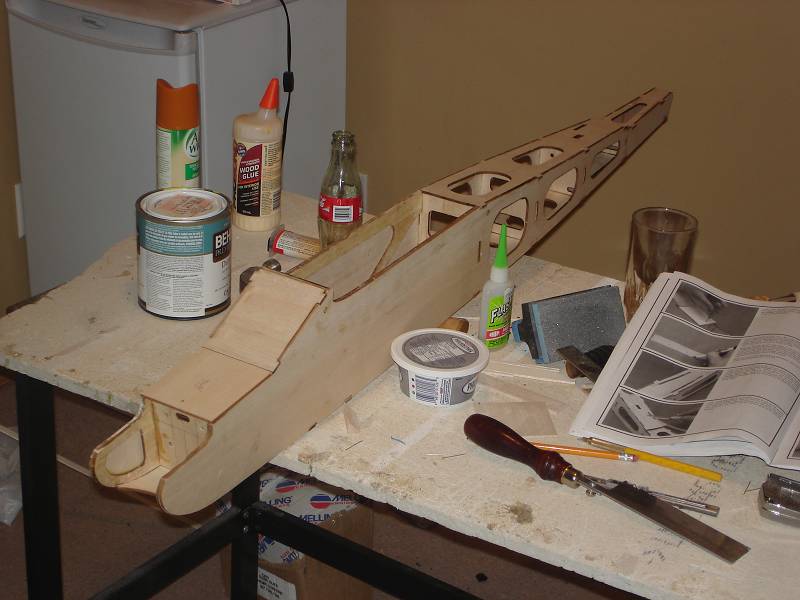

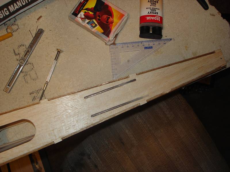

well....heres what ive got done today......
ive glued the fuse together, installed and epoxied the landing gear block and installed all the triangular stock for support on the firewall and landing gear, installed the windshield, fuel tank floor and bottom formers and installed the pushrod sleeves. im just starting to sand the fuse, but will wait on any final sanding/filling of repairs until i have the covering. so far i only have to drill the holes in the ailerons for the control linkages, fiberglass the center of the wing (can anyone tell me the best way to thin out epoxy) cut slots for hinges and sand all the parts one more time.
and how come i cant upload more than one pic at a time?
[img][/img],[img][/img],[img][/img],[img][/img],[img][/img]

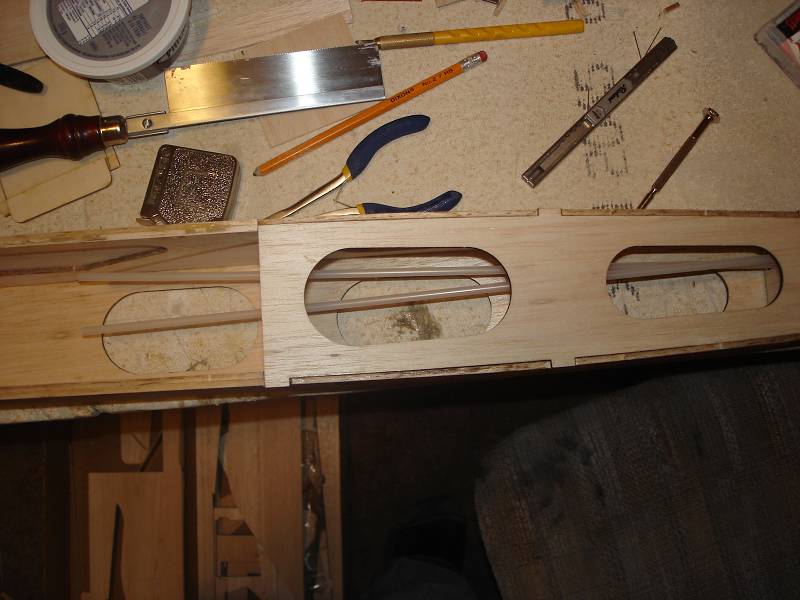

Canada, I think we have a small error (but important).
In picture 2, it looks like you installe the landing gear mounting T-nuts on the outside of the plane. If I am right, they need to be moved to the inside. They will have zero holding power on the outside and will pull out under the first slight load.

Default RE: kadet LT-25 build!
I was just ready to mention the same thing about the blind nuts, other than that looks good

Hmmm, Bruce is on to something. I completely missed that the first time I looked at the pictures. But he is correct. Those need to be on the inside of the fuselage.

i obviously missed it too! ive got some choice words for myself right now[:@].
i guess its time to cool down and try and figure out how im going to fix this. anyone got any ideas?
i guess i could use a nut and a washer on the inside of the fuse, making removal of the landing gear a little more difficult, but at least it will hold it in.

Aren't those just blind nuts?? Use a screwdriver to carefully pry them out and then put them back in place on the inside of the fuse.

Just relocate it to the inside. I know you can't use a hammer but you can "draw" it into place. Get a couple of allen head bolts (LHS) in a size to match the T-nuts and long enough to reach thru the plywood. 1/2 or 3/4 inch long should be fine. Put a washer on the screw (also try to get a larger washer to spread the pressure out) and thread it into the T-nut. The bolt head should now be outside the fuselage. Tighten down the screw and as you do it should seat the T-nut in place. Apply a tad of epoxy around the T-nut to retain it but make sure to keep it off the threads. Let epoxy set and remove the screws. DONE!

If you can't pry them out, try screwing a steel screw into the blind nut from inside the fuselage, then try to tap the nut out of the wood by tapping the head of the screw. You'll want to be sure the fuselage is well supported under the gear block to prevent tearing it off the bottom of the plane.

well i got the blind nut situation taken care of with a little sanding/filling required. tonight im going to rough sand and fill any dents and dings in the fuse. if i have time, i was also thinking of fiberglassing the center of the wing. now another question arises as i am almost completly done the model: what brand of covering is the "best" as far as quality/durability/ease of application?
