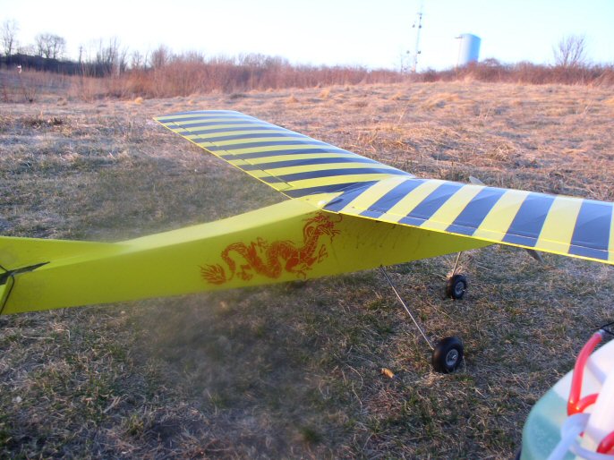

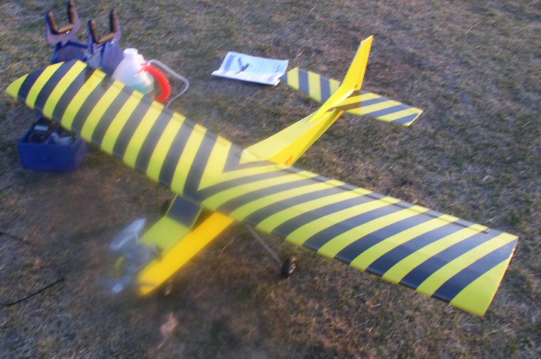

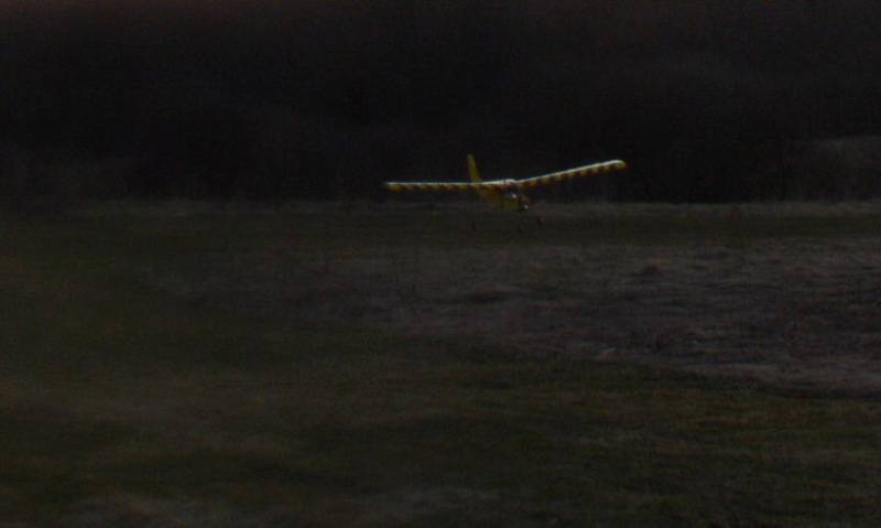

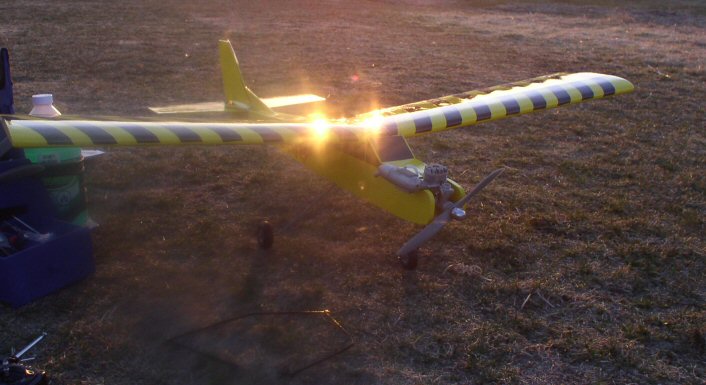

Thanks everyone. I took it down to the field today. Caught one guy on his way out, and he took a look at it and said it shouldn't be a problem. Told me to just get it center'd near the tip and let the inboard side be off. I went back later and caught a guy out there. He checked it out and took it up for me. Trimmed it out and held the transmitter and let me fly with the right stick. He was relativly new of a pilot. Been flying for 6 months, so he didn't feel confident to actually hand the transmitter back and forth. It's been maiden'd now though Yay. Seem'd to fly ok. Here are some pics. If anyone still wants me to get a shot of the aileron let me know and I'll take one.

Old 03-28-2006 | 07:51 PM
jlkonn's Avatar
Posts: 1,418
From: Back home in, OH
Default RE: Done!!!
Shoot!
Looks good!
The ailerons certainly aren't "grossly" off.
Congrats!
JLK

Thanks both of u. Ya, it's quite neat to see it take to the air. I think I want more throws though. I'm use to having to make less movement on the sticks to command a change from aerofly. Or maybe decrease the differantial on the ailerons. I THINK that would increase there athority to roll the plane. Is that right? I won't be doing that though till I'm at the field with someone.
-John
edit --
oh, hehe. U can see the guy who took it up in the second photo way off in the background. Yes, we do have to walk that far to get to the road. Lol.
