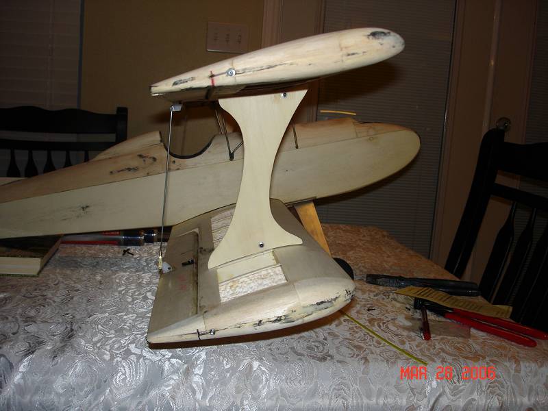

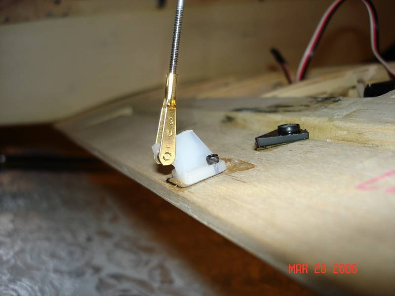

I bought a biplane from a guy at the fly field a couple of years ago. I stripped all the old covering and sanded everything down. I had to completely rebuild the ailerons because they were in bad shape. I am in the process of pre-fitting all the control horns and radio equipment before I start to cover. I have come across a problem. I bought standard control horns for the ailerons, cut them down and attached a 2-56 pushrod to each control horn on the ailerons. I adjusted the ailerons to be equal when in neutral position. When the aileron surfaces are up, they move the same distance. When I move the ailerons down, the top aileron travels more than the bottom. This is the case for both sides of the wing. I know I probably mounted the control horns wrong, but I don't know what to do to fix it. I hope it is a simple fix. Please post some pics that would help describe the solution. Here are some of the biplane pics:

Actually the difference is around 3/8". I would think this would be unacceptable. What would you recommend?

Yep, 3/8th inch is a bit much. Looking closer at your pics, try moving the bottom control horn in towards the leading edge of the aileron, maybe 1/8th inch. That should lower the amount of throw to the top aileron

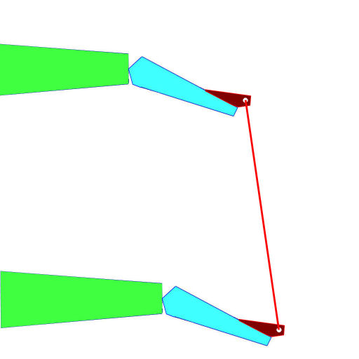

Here are a couple of the diagrams I made for a thread I started on the .40 size Ultimate biplane from World Models. They had hardware in the ARF for coupling the ailerons top-to-bottom. The left hand picture shows what resulted with their rigging. The top aileron was moving much less than the bottom. Shown in the diagram is the result of their rigging. What's amazing is that you actually get a different difference when the coupled ailerons are moving UP!! So when you move your ailerons, one side was seeing different lift/drag than the other side!!
The second pix shows how to connect the ailerons so that they will all operate exactly the same. It's dead simple to do and took me less time than it would have taken had I used the kluged up hardware that was included.

BTW, Bullseye,
With your model and the existing connections, you can leave the lower existing work as it is. Simply take the upper horns and move 'em onto the top of the ailerons and you're going to have a very good rigging setup.
The stagger of the wings causes some of the problem, but provides part of that solution. After you've moved the top horn to the top of that aileron, plug in a connector wire and see if it doesn't make a right angle at both connections. That's what you're after.
